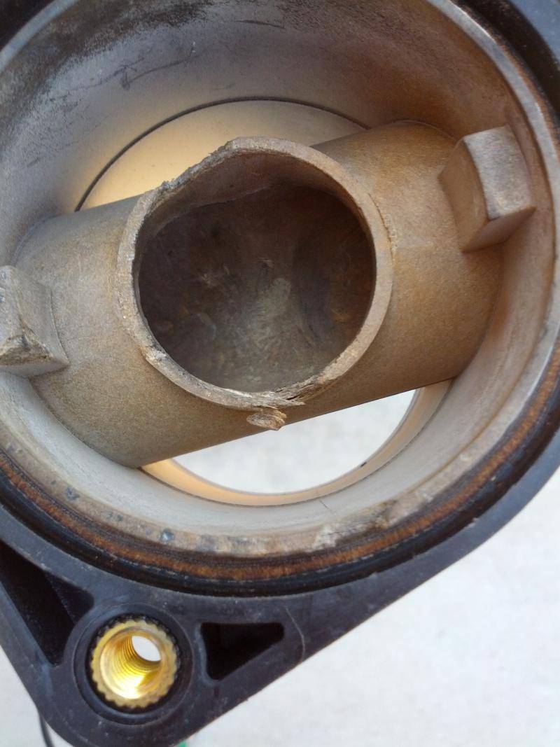

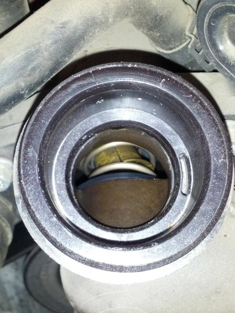

Anyway, when I take off the engine fill cap the attached photo is what I see looking directly into it. The attached illustration is from the guide I'm using and shows the hole I'm looking into.
Now, I don't know what this is exactly, but I highly doubt that copper part in the middle is supposed to be cockeyed and cracked. Can someone tell me what is up with this part and what it does? What am I looking at as far as repair?

That would be your thermostat, and I think it's safe to say it is toast. This why you were overheating with no leak.
How many miles are on the vehicle? If you are up around 100k or more, it would be a good idea to replace all of the plastic parts and hoses in the cooling system, just for peace of mind.

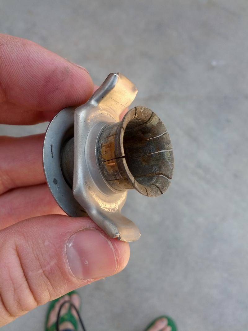

when i had to replace my coolant outlet pipe, upon taking it apart, the thermostat was almost sideways because the parts that hold it in (locking tab) and the nipple it rest into (???) were both broke and crumbled.

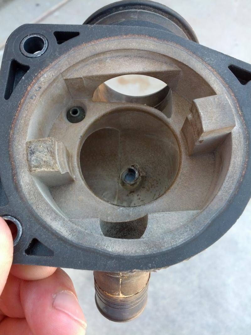

I went ahead and replaced the housing (both sides) and the thermostat. It was a lot of work but not really too hard from a technical perspective.
For anyone trying to do this, the housing comes in two pieces, I would replace both. It doesn't up the difficulty much and you will be replacing the other one eventually anyway. There is a gasket in between the two housing pieces and three gaskets between the housing and the engine block or whatever. I replaced them all except the big one in the middle going to the engine block. I didn't realize it was there until it was too late. I wanted to get this fixed and not wait around for another part.
I'll attach a couple pics of the parts I took out. You will see why everyone is always complaining about the bullcrap plastic parts ford puts in these.
