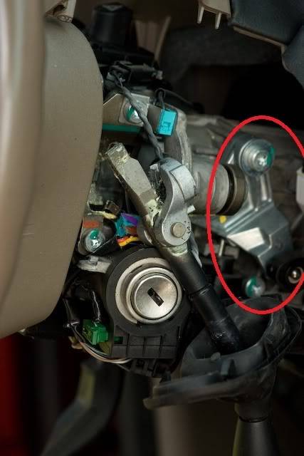

This is the part that is broken. The picture is NOT from the Explorer I am working on and is not broken how the one in the picture is. The part that is broken is circled in red. Its a 2002 Explorer BTW.
No. It actuates the trans gears in accordance with what the gear selector is positioned at. Selector fits into one side, trans cqable fits into the other side.

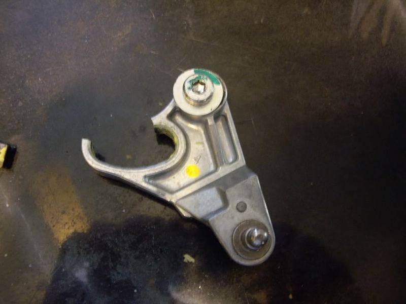

So here is the part. No part numbers on it other then a "4". He managed to break the gear arm too so looks like I will be going to the junkyard.

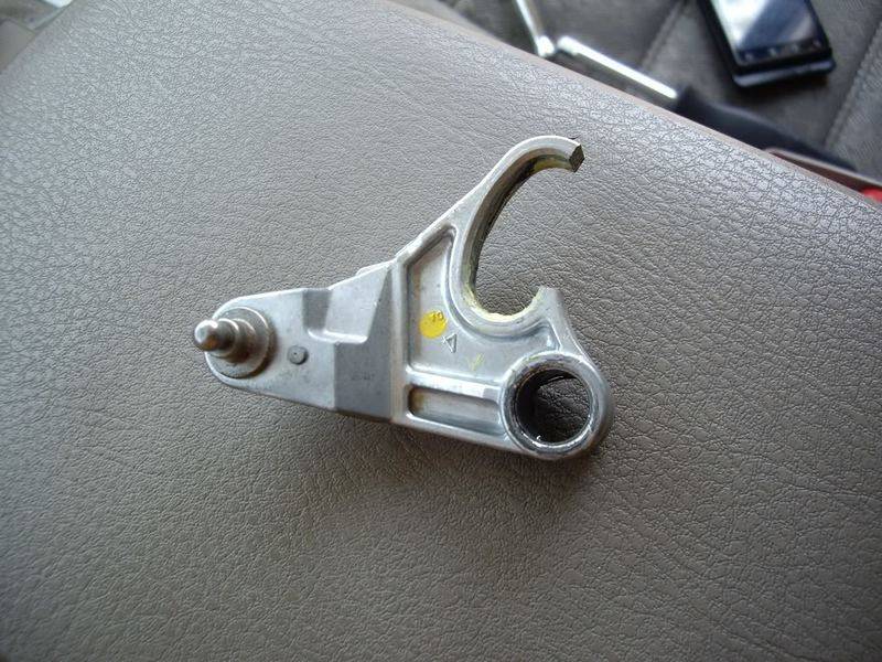

The part that seems to have no name and has no part number on it that I need to get is this one:

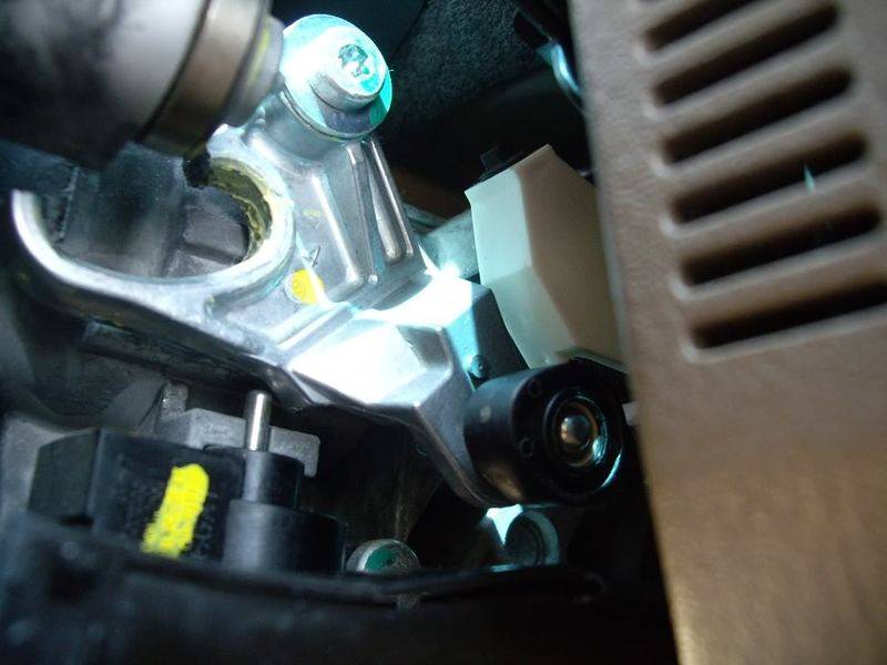

That part connects BETWEEN the gear selector and the cable that goes to the transmission. It is held on by that single torx bolt. The half moon shape side is supposed to be a complete oval. There is a shaft that connects to the gear selector arm and has a ball socket that fits into the oval slot. That shaft and its ball are undammaged and I do not need to replace it but is available for $75 and is the OTHER link people keep posting.
That $75 link (which I do not need) would connect in the empty space between the two parts in this picture:

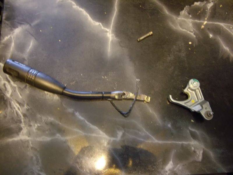

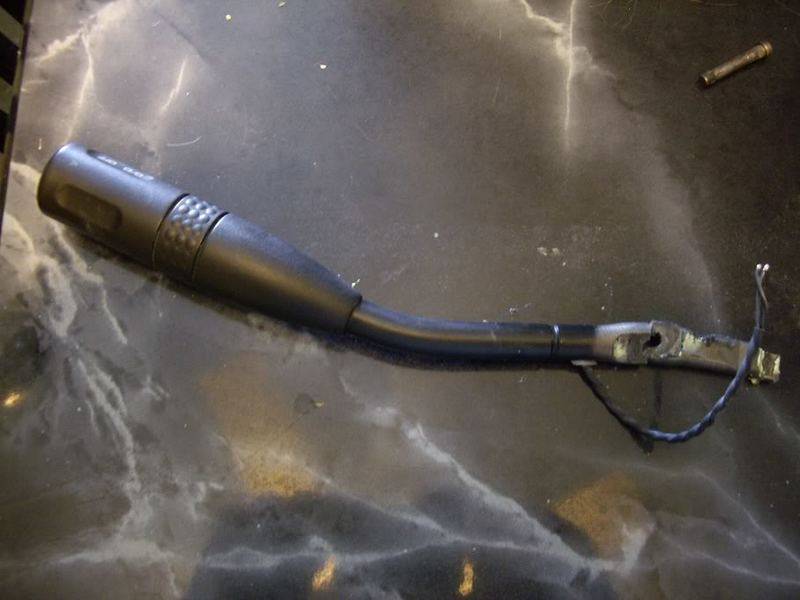

Its like this, his GF is preggers and a big black woman. He pissed her off. Sometimes Explorers (2002-2005) develop a slight time delay on the solenoid that locks the gear selector. While in a furious rage sh YANKED the gear selector and broke that pivot part that has no name. I was called and made it so they could drive it by pushing a micro switch and then grabbing that lever by hand to engage gears.
She once again was using it and got pissed off at him. She couldn't move the lever because she forgot to push the micro switch that pops the solenoid and threw a chit fit and broke off the gear selector arm and also breaking the solenoid.
So now I have to replace the arm, the lever and the solenoid. :lol:
