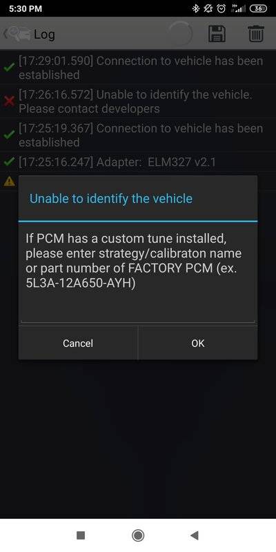

Forscan (lite) with EalM327, error
lincoln_zero
Aug 10, 2012
923
76
ICE COLD CANADA
So it's unable to identify vehicle. I returned to stock from the tune a while ago.
This is the demo, I'm just trying it out cause I already have an ELM327. I'm wondering if I'm gonna have the same problem with the Windows version, if this problem is happening with Android version.
Edit: Title is supposed to say ELM327
I would expect the Windows version to do the same, but I don't know for certain. I would also have expected "return to stock" to put the original factory name back in...
You may have to key in the part number on the label on your PCM.
Does this mean I have to physically look at my PCM? I don't even know how to find the damn thing. I know theres a tutorial on here, but is there any other way?
Ok I'm in. Found my strategy using my SCT Xcal.
