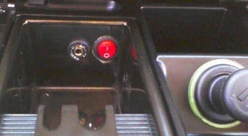

I installed the IS77 in my Town Car (Single CD Head Unit) and it works beautifully. The great thing about the IS77 is that it is first in line to the Head Unit. You plug it into the Antenna port and then plug the Antenna into it. It charges my iPod when in use and there is NO STATIC from bleed over at all.
I installed the ON/OFF switch in the Ash Tray and the control unit fit nicely under the AUX Port. I had the Head Unit out of the LS not too long ago and there is plenty of room in there for the IS77 Unit, which is about the size of a deck of cards, albeit a little thicker. At first, I was going to use the 3.5mm Headphone Jack and my non-iPhone but later went with an iPod Nano. For the IS77, you can have one or the other but not both. The iPhone/iPod Adapter is your best choice.
