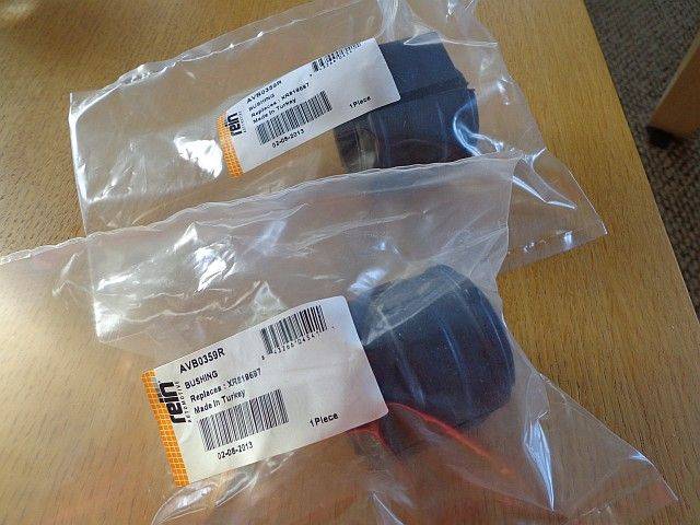

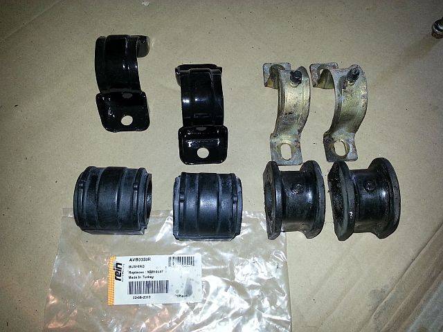

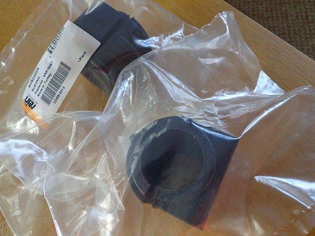

I have an 01 LS Sport, when I replaced my sway bar bushings, I went with ES 30mm bushings, only to later hear from another LVC member that they are not a good fit, they are too narrow and will slide side to side before they are stopped by the flange you mentioned above.
The solution for a 1st GEN Sport is to pick up a set of Jaguar Rein #XR819697 30mm bushings from FCP Euro.
http://www.fcpeuro.com/products/jaguar-suspension-stabilizer-bar-mount-xr819697
(note that if ordering from there, you have to order qty 2, it's not a set as illustrated)

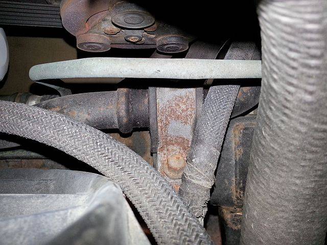

How is that going to help ya, not like it comes pre mounted with brackets already to the car, you'd still be in there getting at the bolts for the bracket, not to mention trying to figure out how you are going to get the entire sway bar in through one side. I'd say, being able to just simply change the bushings on a 1st GEN would be easiest and quickest.
Many 2nd Gen owners opt to cut off the bushing and replace similar to on a 1st GEN rather than buying the whole new bar and get that in.
