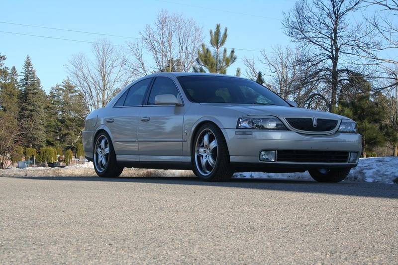

I say repair it, (best method possible) and paint the lower grille black. I wish I could find a good picture of Pektels car from recent but he did that mod and it looks great.
Edit found the picture
Looks like your far upper left part of that lower grille is coming loose too.
Repair with best method, then touch up with color match paint pen/brush from dealer.

I like the painted black idea. That would save you a lot of time, hide the imperfections if you had any after the repair and give you a custom look.

As far as painting it black... I'm trying to picture it in my head and I can see it looking really good or really bad. I'd have to see a picture.
pektel's car with the lower grille painted..looks awesome if I had the standard front bumper I'd do it too
