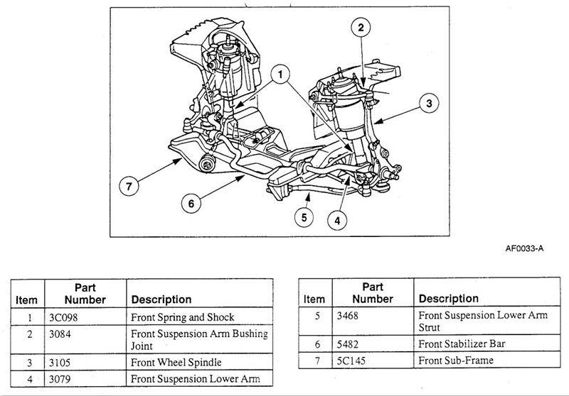

what are the front suspension parts named? Upper A-Arm(has bushings and ball joint, lower control arm has 1 bushing and ball joint and the strut attaches to it. Then what is the rod that goes from the lower to the frame? Is it the strut rod? Last question, is any of this right?
thanks for any help.
Here you go.
