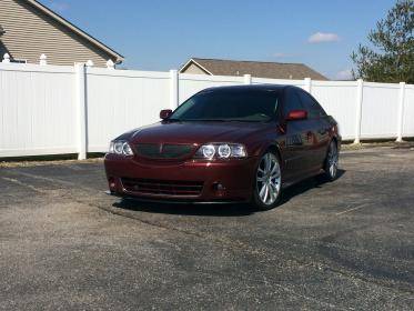

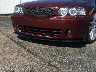

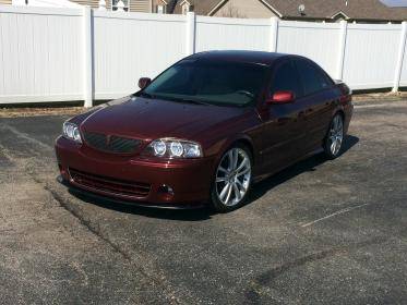

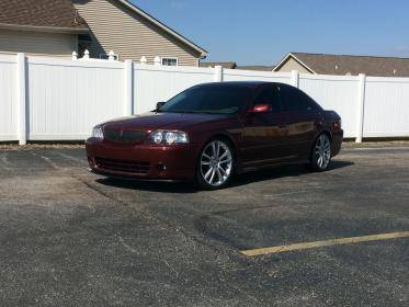

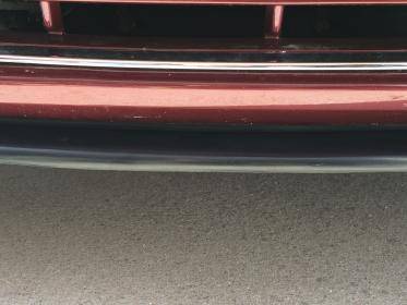

Another first. Love thinking outside the box. I bought a BMW M5 lip spoiler off eBay. Slight mod to make it fit gen 2 LSE bumper. Used 4 of the factory screw mounts. I did have to drill two holes on each end to mount.
$69 on eBay. Free shipping. Search "BMW M5 lip spoiler". You will need to get auto/marine weather stripping to get the lip spoiler to mount without a tilt.

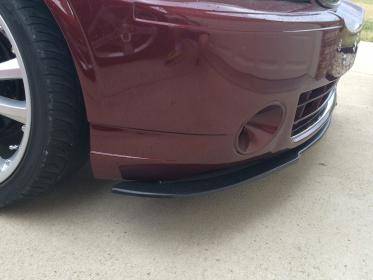

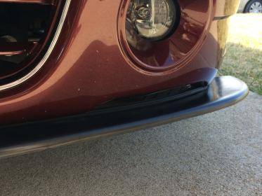

Install from underneath. I had to drill the holes through the lip spoiler myself. So measure it currently. I used extra large washers to give better support.
been looking at options for a front splitter, dont think most would look nearly as good on a sport bumper. that looks like a much better fit than most of what I've seen.
The lip spoiler I used is only 10.5" inches deep. Our cars need one about 13" inches deep. The one gave fits good. But a deeper design would fit better on the ends.
