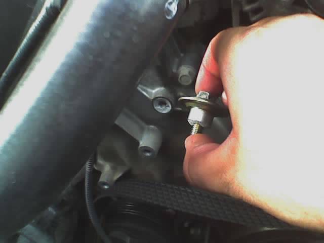

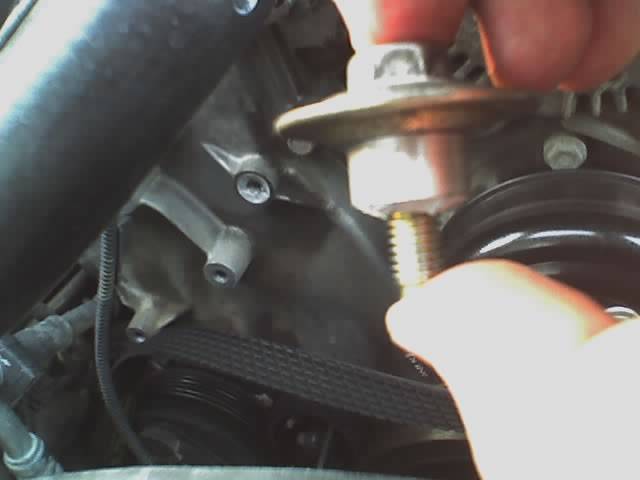

ok, so about 2-3months ago i replaced my idler pulley for the second time since ive owned my LSC....when i got my car i replaced both tensioner and idler (may '05)........and now i think i know why they went out this time around......this past week i started hearing this distant 'tick-tick-tick' very faintly, when i put the car in gear........i was freaking out thinking it was a tranny problem, but started looking around the engine bay for the sound......so narrowed it down to the pass side of the engine, checked my tensioner pulley, it looked ok, then took off my idler pulley.......and the part of the front cover were it rides off of, came off with it..........
yay
....... so i tried to torque it down at 15lbs, that just took off 3 threads off of the cover
, so i just got some thread lock on the bolt and got it back in there and hand tightened it, about half the bolt is still holding on the cover, this was friday night, its holding no problem so far.......maybe somebody before me, or me, might have tightened too much
