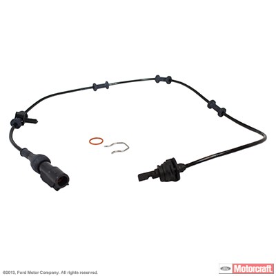

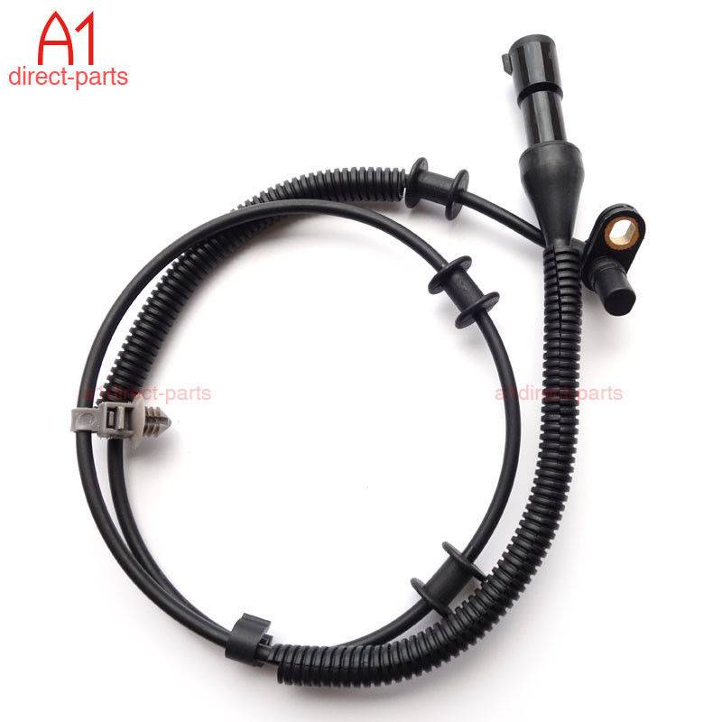

my front right wheel hub has a little play,,i want to replace it,but my question is if i have to change the the two wheel hubs( left and right? bacuse the wheel hubs that are on my car have clip on abs sensors and the one the autoparts store sales,have bolt-on abs sensor,does this makes a difference to the computer or causes problems on the abs? thanks in advance for any advice abs clip-on.jpgbolt-on.jpg

Get the autozone Timken bearing brand, lifetime warranty. Don't worry about the wiring, it will connect. You only care about what is at the plug end; how it gets from the wheel speed sensor to that plug is not our concern. Be prepared to have fun separating the old hub from the knuckle.
This.... Timken is the way to go!!
ok thanks for your help,,,i will get the timken brand,and i am only going to change the right side and leave the left one as it is now,,since its working fine and has no play
Yes, you only need to replace the side that has a problem.
