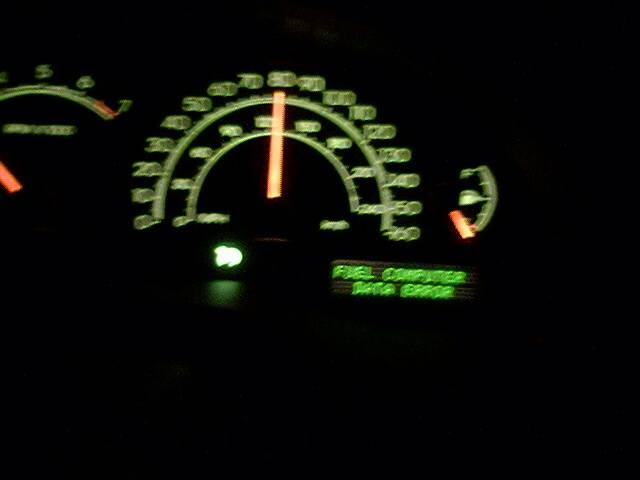

Maybe some of you have experienced this or similar. While driving my '04 LS V8 with the computer display showing approximately 50 miles to empty, the fuel guage dropped to the extreme "E" position and the display said "Fuel Computer Data Error." Knowing that it had said 50 miles to empty only a mile or two before, I continued at highway speed, expecting to gas up in about 10 miles.
After about 6 miles, the engine caughed and acted as if it was out of fuel. I pulled to the shoulder, expecting a 2 mile walk. The engine continued to run, however, but would not go above 2,000 rpm. I made my way up the shoulder with the engine running roughly any time I tried to accelerate, but made it the 2 miles to a station and gassed up.
Once the tank was full, the display went back to normal and the engine ran fine. On the next tankful, the display repeated the error at about 120 miles to empty and I wnet directly to a gas station. Third tank, repeat performance at about 70 miles to empty. This is the third tank of gas since the car was new.
My Lincoln dealer service tech is mystified. Any ideas?
Sorry about the fuzzy picture. Taken with my PDA at night at about 80.
I have never had this happen before, but I have an idea of what is going on. It look like the fuel level sender is intermitent for some reason, either the sender is going bad, or there is a bad connection. You dealer should be able to determine this using the Datastream feature on thier diagnostic tool. As for the engine reducing power, id say it is part of the LS's adaptive strategy to prevent an over lean condition. When you car sees that it will soon run out of gas, it reduces engine power, richens up the fuel, and increases pressure while at the same time limiting speed and rpm. The LS engine will also do this if it ever overheats for any reason, in this case it is a fail safe cooling method.
The dealer will take care of the issue however they feel it is necessary, but if it were my issue, i would do the following: I would drive the car with low fuel (whatever lever you see this happening at) with my OTC Genysis logging datastream durring the entire run. When i see the error message come on the cluster, i would look to see if the fuel sender was active on datastream (i am able to read both a sender voltage, and a level percentage) if no signal, i would replace the sender. If there is a signal, i would look into a computer problem. Now, assuming you do not have test equipment at your disposal, you might want to offer this tip to the dealer, and see if they could do something like this for you.
Hope this helps you fix your problem, let us know how it turns out.

Thanks Mike. I will probably take the car in next week if I can run that much gas out by then. I'll post a reply once the issue is resolved to share with the Group.
