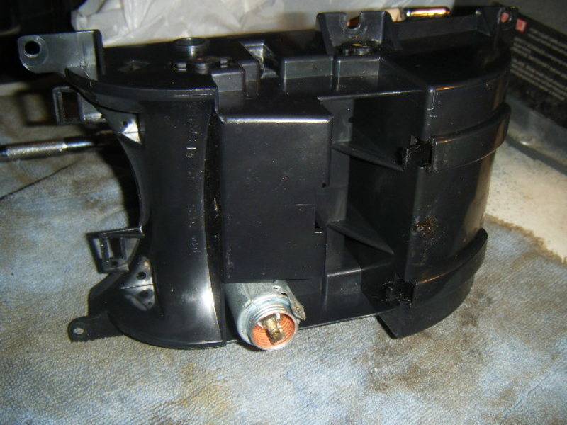

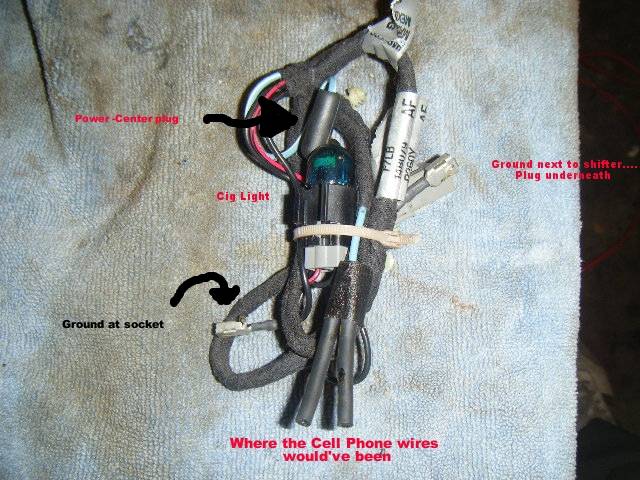

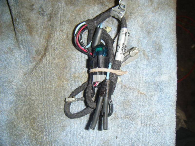

A couple pics of the console I took apart last year....
Harness-
Bottom of socket-
The light is on the same harness but has separate wires feeding it.
correct. the lighting power comes from the dimming interior light stuff circuit.
the actual power for the cigarette lighter comes from elsewhere as it is constant 12 volt power.
its usually that the connector for that middle terminal has fallen off.
Is it possible to get the piece you have pictured there out without pulling the whole console?
Yeah, just pull the panel and it comes out with it. The ground almost ALWAYS pops off. I ended up just yanking mine out and using it as a relocation spot for my OD button since my shifter handle has a broken switch inside.
I'm almost positive that the socket can't be removed from the top as I believe something secures it from the bottom. You'll have to remove the entire console. :(
