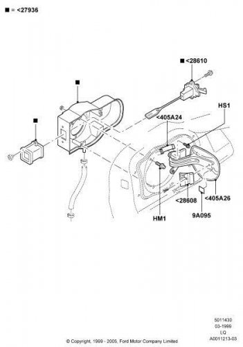

Per the owners manual, you may be better off to open the fuel door via the release cable in the trunk.
As to why it will not open via the button on the dash. I believe the door is operated electronically via a solenoid? Maybe a cable setup?
this happened to me last spring, there is a little piece of flat metal (kind of a spring) that pushes the door open when the button is pressed, this broke off on my car so when you press the button, you can hear the solenoid pop but it wont open past the latch.
this isn't a huge problem for me since i can pop the gas door open from my viper remote, so i just have to be next to that gas door, push th button to open it and then for 1 second its released, i need to grab the door with my finger and pull it open.
to fix it the spring need to be replaced, i haven't really looked into how easy it is to remove from the door, but i got an extra gas door with a good spring that i got from a junk yard but i moved at the end of summer and have not found it yet :(

the spring is like 10 bucks from ford and has one or two small screws holding it on. I had to replace mine last year.
Mine used to do that. The spring wasn't broken, but it had bent a little over time. I bent it back into shape and haven't had a problem since.

I would say spring adjustment or new spring.
the door is simple, there is a spring pushing outward on it at all times (this should be easy to see when looking at it)
pushing the button operates a solenoid that releases the latch and the spring should push it open...
