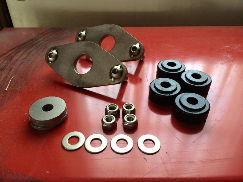

My shock mounts as mentioned above by Lownslowlsc are $66 shipped, and are 100% stainless steel construction, including all fasteners and washers, and include Energy Suspension poly bushings.
See pic below:
