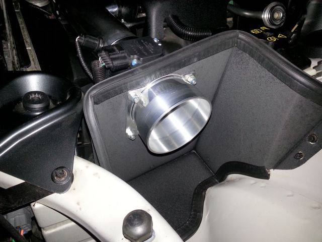

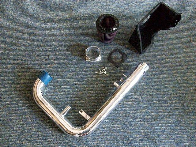

I've seen some pics of users gen 1 cold air intake systems. I can't find it anywhere online though. And I'm talking about true cold air. Not just the tube and filter. Looking for the box that seals when you close the hood. That's a cold air intake.
Thanks
~ Replace the sh!tty blue coupler with a Vibrant hump coupler.

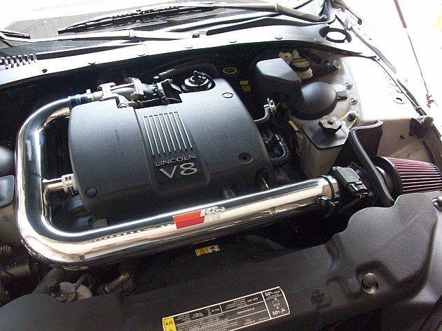

Seen your setup before. Got a link to where I can buy it? I like that it doesn't require a coupling at the 90 degree bend like a lot of the ones on ebay.
The seller is ASMI on ebay. You may have to email him because he doesn't always list them but he has them. The heatshields are on hold till my life calms down. Sorry.

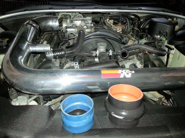

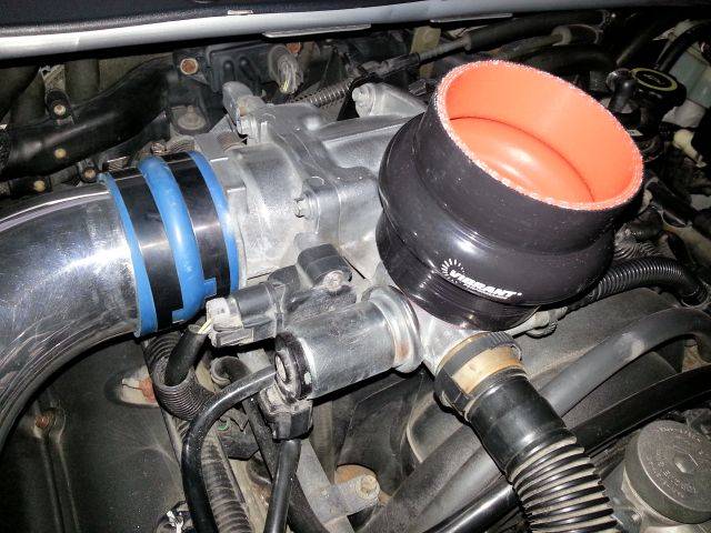

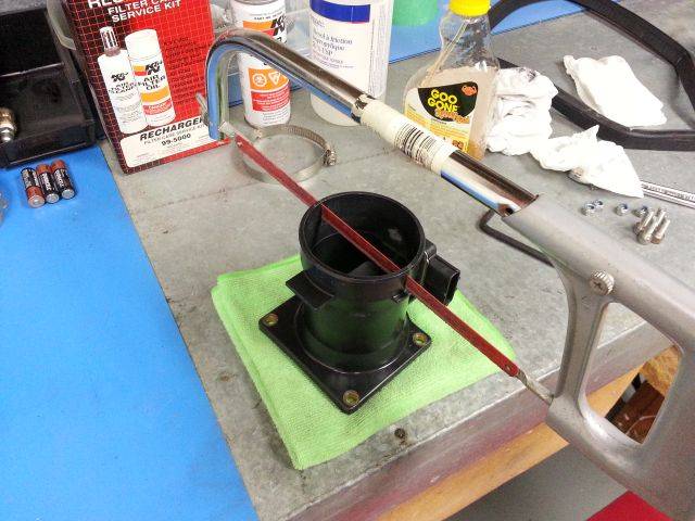

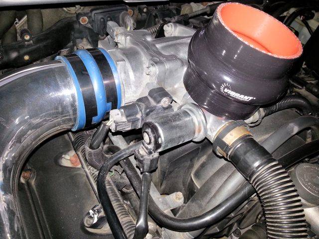

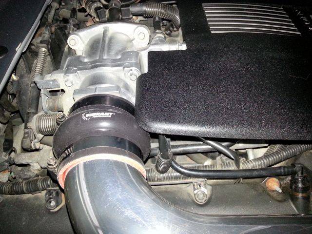

Little extra info on the subject of intake and coupler.

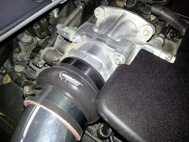

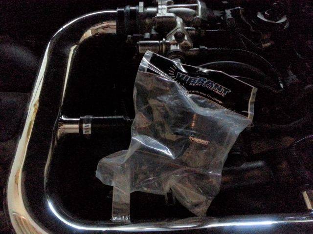

Swapped out that BS ASMI intake excuse for a coupler with a Vibrant Product hump coupler.

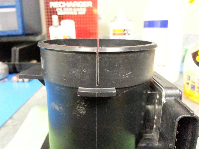

... I've always had troubles with the MAF housing not clamping down fully on the ASMI intake tube, the diameter of the housing is pretty close to the same size as the intake and it's hard plastic so it doesn't allow for any clamping force to sit tight. I've had tape wrapped around the tube in hopes of getting better clamping force with the MAF housing but the tape just gets warm and moves around.
So ... as I have the whole thing apart this weekend for cleaning of the K&N filter and redoing of the HITE heatshield, I opted to put a cut straight down the middle on both sides of the MAF housing, thereby giving it a gap and allowing it to close tighter when locked down.
The idea seems to work perfectly.

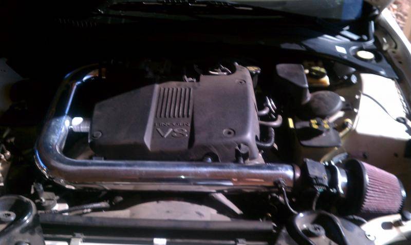

Just finished mine. I guess I could have cleaned some of the dust off hahaha. But hell, that's living in Shi**y AZ.
And what a difference. Runs better (no surge). Quicker throttle response. And sounds good too.
Thanks Big for the update on the MAF sensor fitting to the tube. I was wondering about. Good idea.
Yeah, it puzzled me for a bit, I tried different clamps, tape around the tube, which only got hot and moved around. Until one day I said enough of this thing not sitting tight. Took it apart and figured it needed a line cut down the center on both sides to allow it to close tighter onto the tube.
