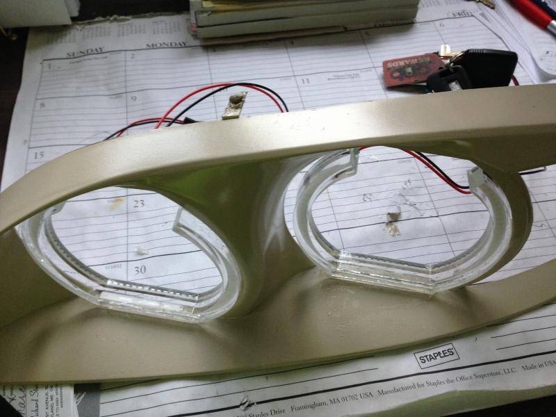

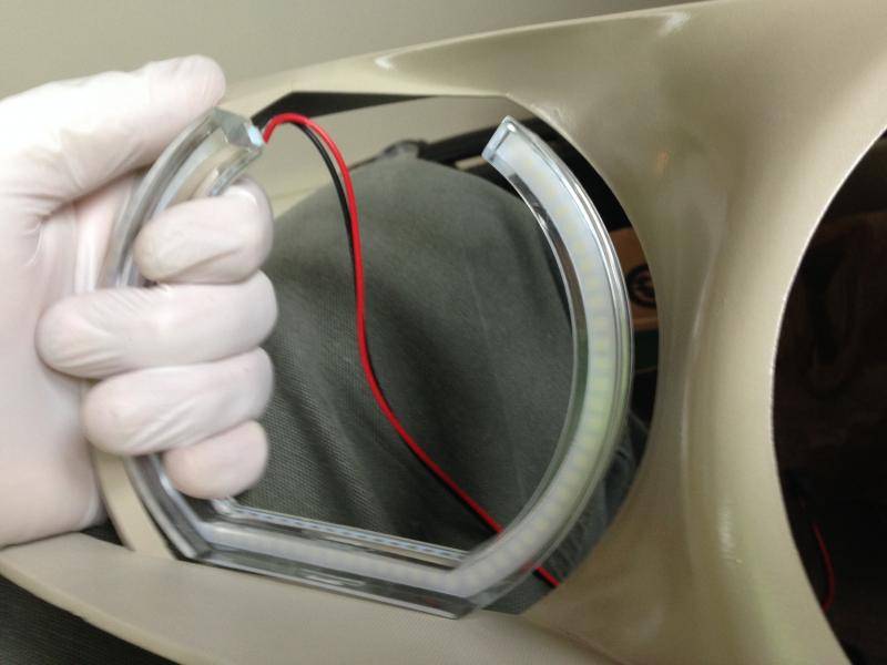

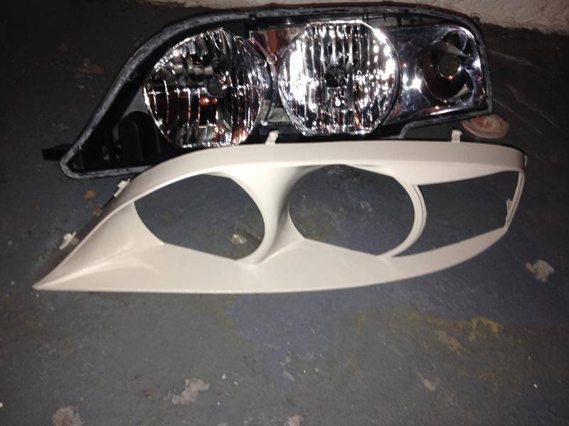

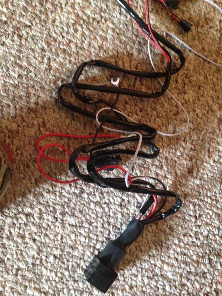

Hi all, Here is my car and newest prodject. I am using E9X/E60 flat bottom rings 181.jpg015.jpg026.jpg024.jpg002.jpg006.jpg007.jpgNow I need assistence in wiring.

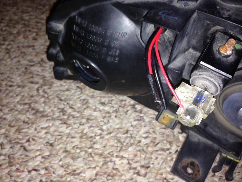

There are different ways to wire them. Do you want them to be on any time the car is awake (wakes at unlock, sleeps 30 mins after lock). Do you want them on with just parking, head, or fog lights? While running?
Keep in mind the positive wires for the lights is on when the car is awake and negative is what is switch on and off

I always run my lights on automatic to turn off after 10-20 seconds, I was hoping to use this. I'm not sure I want to drive around with my parking lights on during the day.
So I'm guessing you want them to be on both when running and when the headlights are on? That's still pretty straightforward. Use a relay setup where it has two "switch" wires. One goes to the headlight negative, one goes to a negative-in-Run wire. Put two diodes, one on each wire, to prevent the headlights from being on all the time and to prevent the headlights being on doing something whacky in the other direction. Being a Gen 1 (right?), you'll probably want to actually add a 3rd signal wire (w/ diode) to the highbeam negative wire to keep them on when you use your highs. The other side of the relay goes to a positive wire. You could probably use the positive wire on the headlights.
Unfortunately, I can't tell you which wires to use for the negative-in-run signal and the actual power wire for the rings

Body matching the black part of the headlight eh? Might be nice. While I'm not a fan of angel eyes, I'm looking forward to seeing them together.
