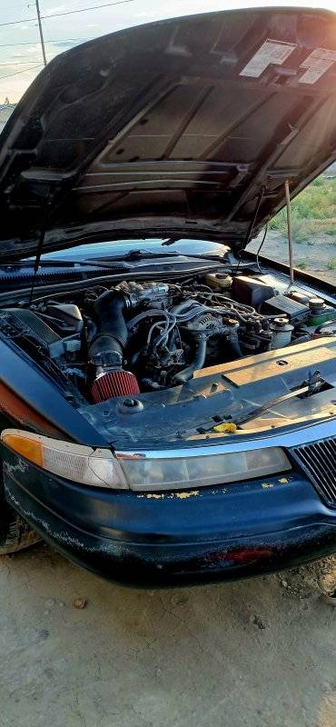

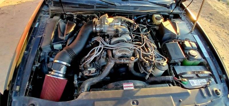

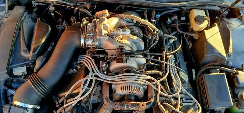

It does fit. I just got done with a full gen 2 intake swap on my 96 lincoln mark viii. I recently got a gen 2 intake from a junkyard along with the throttle cable and vacuum hoses and ordered the fuel rail and throttle body. But the vacuum hoses come off as awhole piece together and fit directly and the fuel lines from the gen 1 mark viii wont fit so you gotta use a gen 2 fuel line along with the fuel rail. I wasnt able to get the fuel line so from my 96 mustang i was able to use the fuel connectors and just extented my fuel line to fit across to the passenger side fuel rail.. the idle air control connector has to be extended and i entended it with my connector from my 96 mustang gt's.. theres a little bit different hoses that come with the gen 2 intake that replace the old ones like the pcv hose that connects with a T to the intake plenum.. i will post pictures of the swap and i do have a 96 mustang gt that im using for spare parts for because some parts are the same..at the moment my idle air control is out and im using my mustang iac and is working.. i honestly like the intake from a gen 2 better than a gen 1 because if you know the gen one throttle body is buried in the fire wall almost and the gen 2 is similar to a mach 1 or 2000s cobra intake. I know i forgot a few other details but i will answer some thanks
Heres some pictures of it fully done.. mind the egr delete plate. Before installing it i ported the intake to the same opening as the imrc plate and it was a big port i did for it and was worth it.. i am running a 2000 ford taurus imrc and is the same as a mark viii other then that.. my car is a 1996 Lincoln Mark VIII LSC with a Gen 2 intake swap everything is stock
