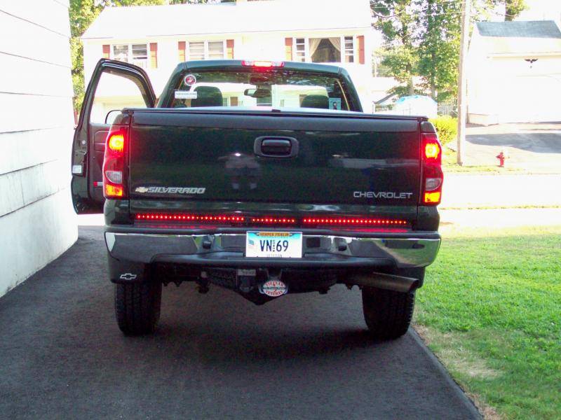

What I found was a red strip that is marketed as a strip that goes below a pickup tailgate and has brake/tail/turn all with a trailer type connector on one end.
So first on my list is to find a spare and carefully take it apart. I like the LED matrix, but I think a red strip at the top will better carry the original look and improve reliability at the same time.
They come in 3 sections wired together. One kit makes them turn white for back up lights.

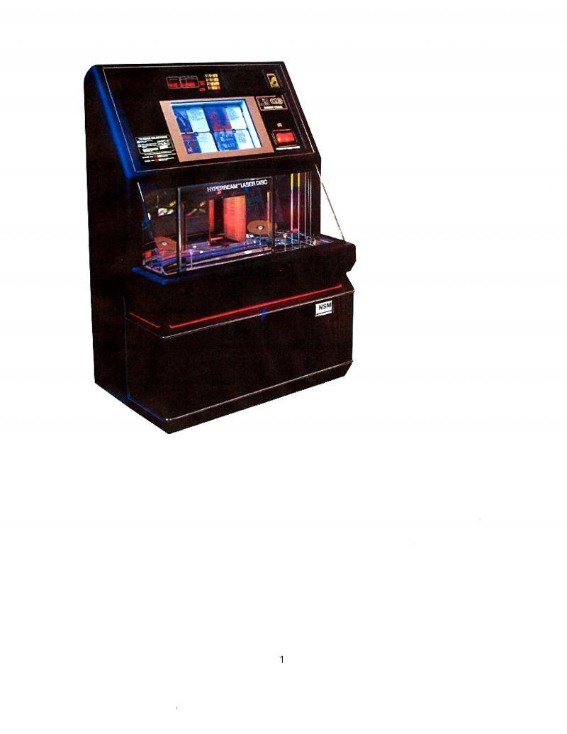

LIGHTING IDEA In the late 90's a juke box company NSM from Germany, installed a 1/2' strip of red plex across the front of the machine, that had the edges polished. In the machine there was a fluorescent light that shined on the back of the plex. It looked just like a neon light. Worked like fiber optics sending the light through. I thought is was a neon light, until I looked inside.
