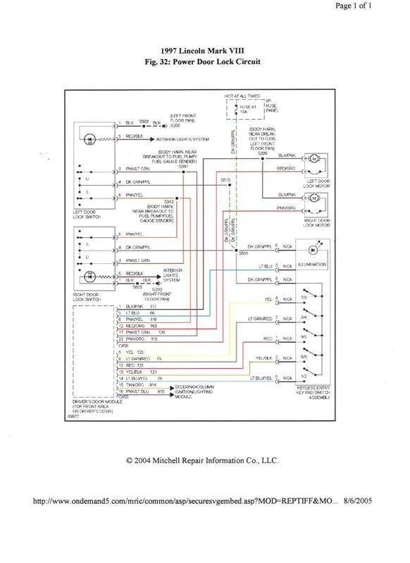

i need the wireing diagrams for for a 97 gen II ( base model ) door panels , i need to know what each wire dose.
i got the door panels to fit and the windows work on but i cant get the door locks to work.
