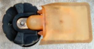

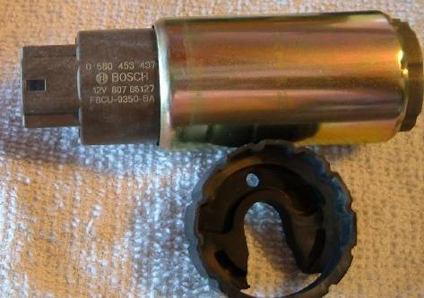

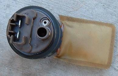

I was thinking that I was doing pretty good to upgrade the fuel pump. I read plenty of threads and looked at many pictures and had organized accordingly. I see that I didn't do enough research into what I was getting into. Oops. So much for getting this done in one day.
I bought the wrong Walbro 255 pump and being the weekend, the work isn't going to get done. I posted this in response to the lack of GenII Tech. pages. I saw some good photos and info posted about GenI pumps and "how to". I'm doing my part for the next guy who may rely on the site to post info and experiences.

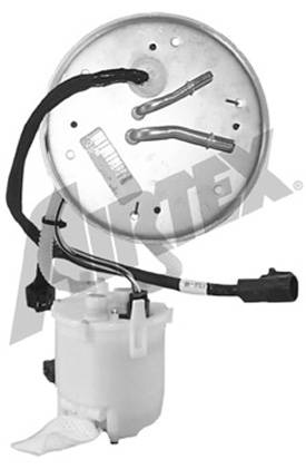

Parts are form Rock Auto;
MOTORCRAFT Part # PFB75
{#F8PZ9A407JB}$274.79 (entire assembly, see Pic. below)
BOSCH Part # 0580453436
{FUEL PUMP #580453436} $121.79 (fuel pump alone)
**Non-stock item--shipping delayed up to 7 business days**
At this point, I need to find the right Walbro part number that will fit a GenII.

is that a new fuel bucket for a cobra?
I cross-checked the parts from Rock Auto looking at the pictures of fuel pump assemblies. The Mark VIII and Cobra of the same year has different set ups. The Cobra high pressure looks like it might work with the filter being small enough to fit in the "bucket". Did you put a 255 in a Gen II?
I got a Walbro 255LPH HP in my Gen II. Same one the goes on the Cobra. Had to modify the pump bucket, as that pump is a bit taller than the OEM pump.
You will also have to fold the filter a bit to get it to fit, but I haven't had any flow issues, and I suspect neither will you.
I will see if I can get you the part number when I get home tonight/tomorrow am if you wish.
yes, i did mine in a gen2.
the cobra's sock didnt fit in the bucket, i just cleaned out my stock one (which was pretty clean anyway) and reused that.

The SVT Focus and Aviator pumps are direct fit for the Gen 2 and flow good numbers...
Any year SVT pump or any year Aviator pump. Remove the pump motor from the focus or aviator pump bucket and direct swap it over to the 2nd gen bucket.
