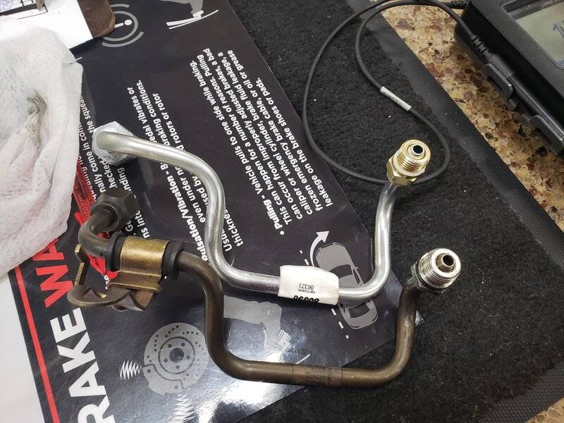

I stopped by the shop today to put eyeballs on what's going on. Here's a picture of the Duralast part next to the stock one they removed:
The mechanic says (and I can see) that the "U" bend on the Duralast protrudes slightly further out than on the stock part. He says that being shaped this way, he can't position it in place to attach the fittings, and that if he attached it to the pump before installing the pump, the bend would hit the motor. He said the part he ordered from O'Reilly is shaped the same way.

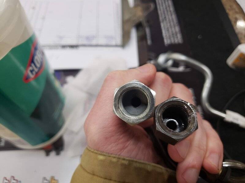

He ordered a "Sunsong" part that has the right geometry, but the female end of the line is missing the inside bevel that the stock part has:
Because of this, he says that when he starts to tighten the fitting, the teflon washer bulges out and deforms instead of seating and sealing as intended. He ordered a second Sunsong part on the assumption that the first one might have been a factory defect, but the second one was also missing the bevel. (Incidentally, the Sunsong product photo on Rockauto shows no bevel.)

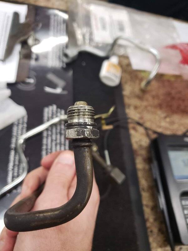

I asked why they couldn't just use the stock part and he pointed out that the male side is bent slightly:
He said that it looks like someone previously replaced the A/C compressor and pushed on this part rather than removing it in the process. (This same shop did replace my compressor about 8 years ago.) He said that it appeared to be working fine and not leaking when attached to the old PS pump, but with the new pump installed, he said the stock pressure line doesn't quite line up with the ports and he's wary of trying to bend it back into shape.
