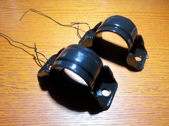

It's advised as Hite mentions, to retain the old brackets, clean them up ...
.. and use the OE Jag bushings for a tight and perfect fit.

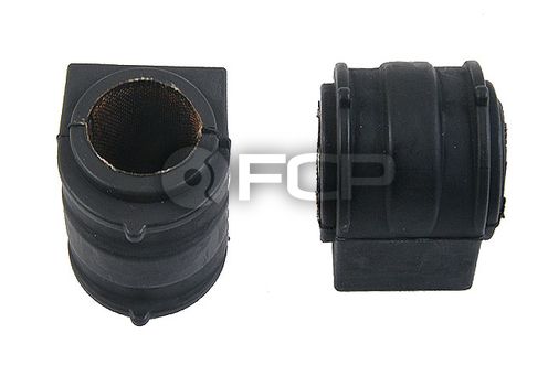

Jaguar Sway Bar Mount - Rein XR819697
http://www.fcpeuro.com/products/jaguar-suspension-stabilizer-bar-mount-xr819697
~ Up to you of course!

Its like bigrig said, the ES bushings are too narrow and there is a gap between the bushing rest and the bushing itself. The link I posted above is the best option if you have a sport suspension with the removeable brackets. I have had both and the ES bushings will work but they are not as good IMO.

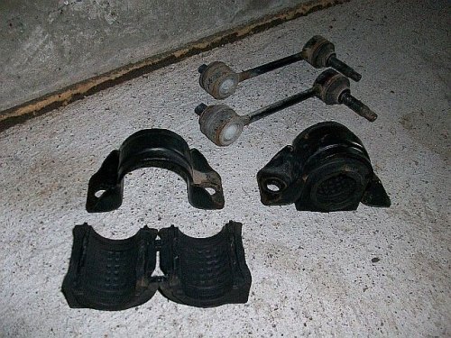

and the credit goes to Hite, he posted his findings of the perfect fit JAG bushings with the split in the middle to replace 1st GEN LS sway bar bushings.
Please note,
2nd GEN sway bar bushings are not split and removal requires cutting off the entire bracket and bushing as it's molded around the bar.
1st GEN has a removable bracket and split bushings and does not require cutting out, bracket can be reused.
Correct me if I'm wrong but that's what I learned when I went through this.

Unhook the stabilizer end links and move the stabilizer bar. You will notice alot of play. Also if you have a lot of miles on the car they are probably bad.
... and like most, if you're in there replacing sway bar bushings, it's probably time for some fresh front sway bar end links as well.
