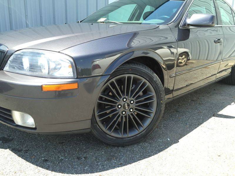

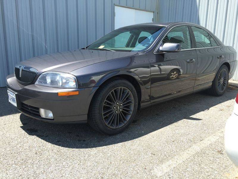

245/45ZR18 on Ford Fusion Rims (18x8, 55mm offset), plasti-dipped Anthracite Metallic (please excuse the overspray, I'll clean it later). Lincoln MKZ center caps.

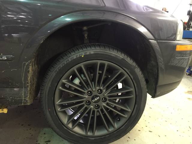

Test fitting shows the caliper BARELY scrapping the wheel spoke. Ordered custom 5x108 7mm spacers with bore centering lip for the wheel.
Should look pretty nice when It's bolted down and the chassis is settled around it.
And they don't clear the caliper?? They should with that offset.....
I thought the same when I first decided to buy the wheels; however, the front calipers definitely leave a witness mark on the back side of the spokes. It's sooooo freaking close, like 1 more mm would clear. I opted for the 7mm spacers because I want to have room for brake upgrades in the future.

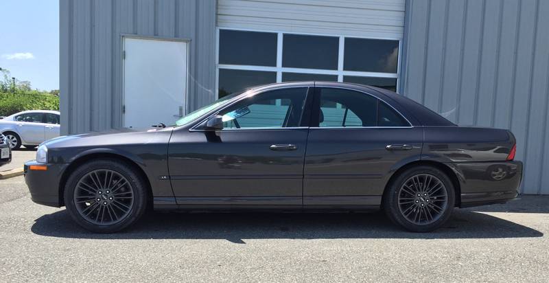

Looks good, nice looking wheel, always did make note of the Fusion to LS fitment.

Wheel installed! I had to go with extended thread lug nuts. I rather like the look, reminds me of a BMW m5.
Yeah, nice match on that, looks great, thinking of possibly lowering it?
