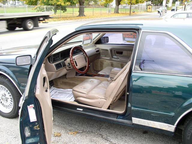

OK.
I've been quiet long enough.
If it's a Green 1992 Lincoln Mark VII LSC Florida car with no rust and a cream or white or tan interior and is selling for under $1000.00 and Dude doesn't take it, then me and Josh and Jerry are taking a road trip to freakin' Miami.
Josh, you bring the pretzels.
John "I-Let-This-One-Get-Away" Dancy

Sounds good to me. Dude didn't say if it is green, though. Last time I went to get a car from Florida was quite memorable, what with all of the beer, no sleep, and 16 hours of straight driving. :p
