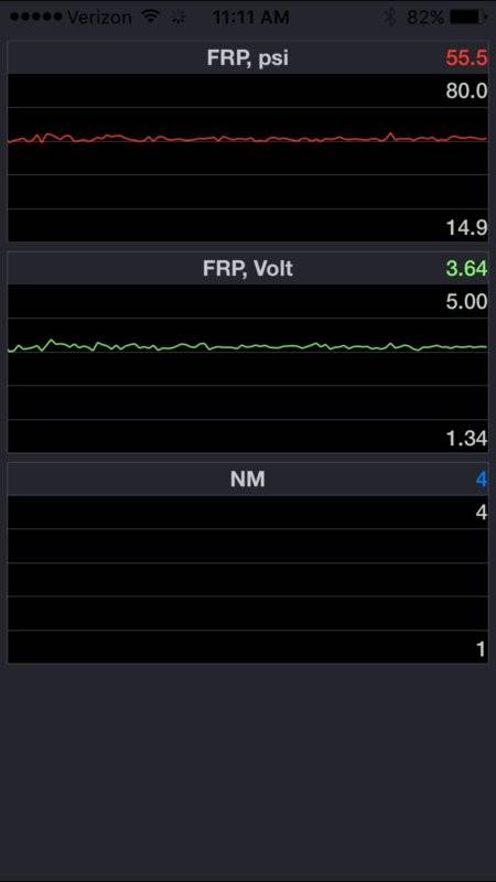

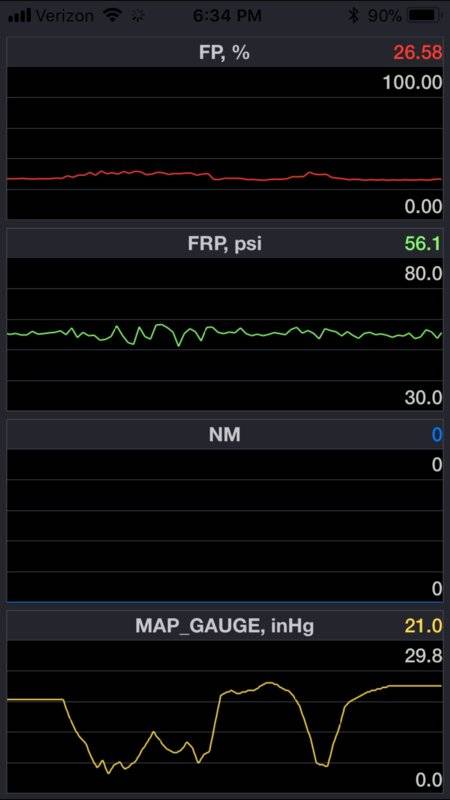

This is an image of maybe 4 miles in, pretty steady on pressure.

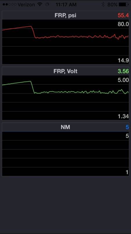

Still didn't feel anything, but could see a weird event along with another mis-fire count.

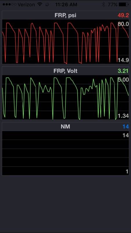

Then things got really shaky, pressure wise and mis-fire.

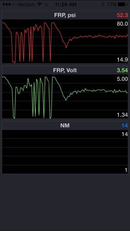

And a few seconds later this is the trailing graph.
In the driveway, this ....
Pretty calm at low volume draw at idle.

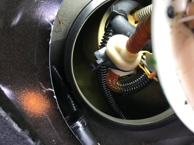

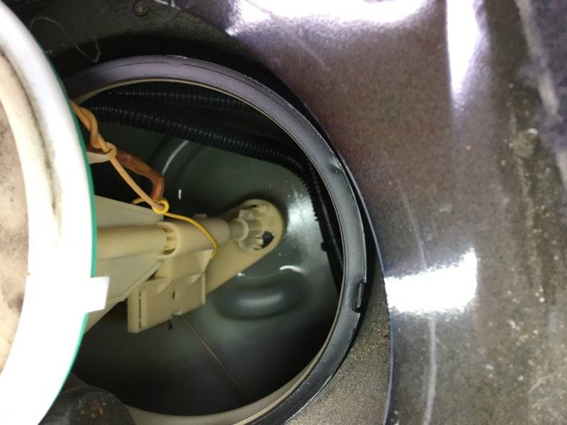

So today I thought I'd open the tank to see if I had a fuel level sensor issue, socks going bad, something visible before I start spending bucks. So with the jet pump side open I thought I found my problem.
It's empty down there.
But since I've not had to deal with this before, I'm not sure how this works. Are both sides of the tank kept balance in volume or something else.
So time to open the true pump side. It's hard to see with this image, but there's a decent amount of fuel in there.
I'm guessing that the drivers side gets transferred over to the pass side, unless there is a fault here.
So has anyone gone down this path before with this issue.

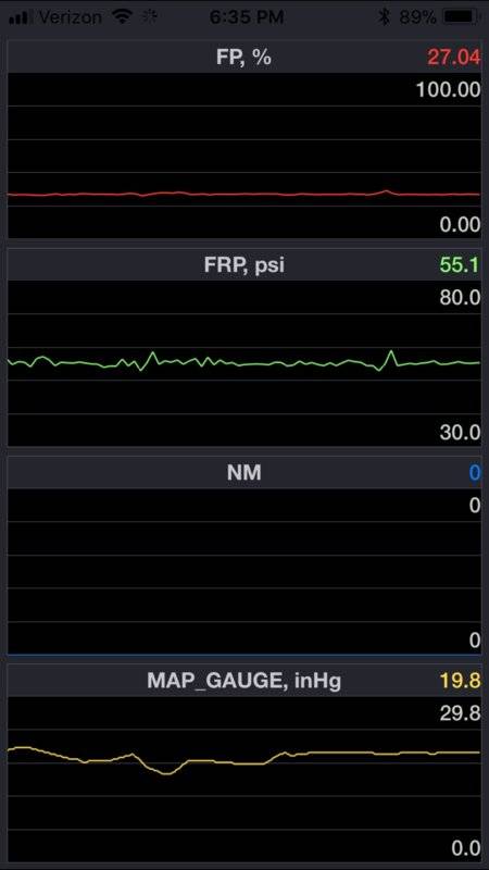

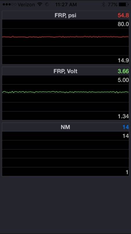

So now some changes from the other day which are the electrical connection to the pass pump has been removed and reinstalled, $20 of gas added (low fuel went on) and the coil cover on the right bank is off. Damn thing ran fine today with no mis-fires. Fuel pressure can show a few pounds squirrelly, but I have no history of watching that readout.
On acceleration ....
20 mph by home .....
Maybe the connection, maybe the added fuel, maybe the coil cover off (less heat) .......
