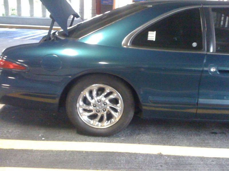

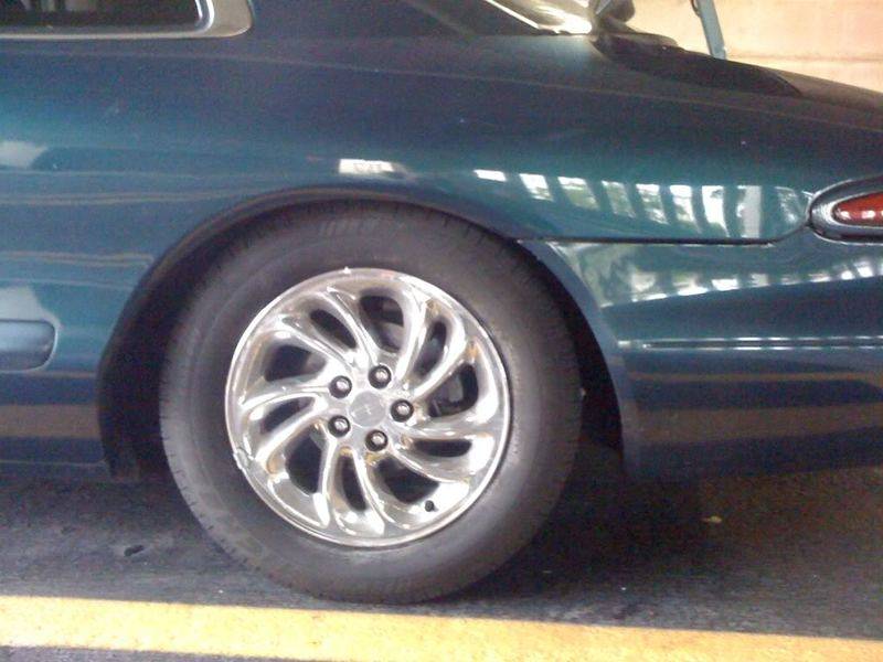

some photos for your viewing pleasure
yeah its down a lil, got alot of weight in your trunk, speaker box, dead hooker etc?
did the front drop or just the rear.
Trunk was empty - no dead hooker LOLOL... just the rear dropped (i think...?)
If the front did lower, it wasnt noticeable.. but the back went from being normal all night, I put the key in and PSSSTTTTTTTTTTT
ok well the front will drop faster due to the eng weight, id say you got some bad rear bags. if the rear solenoids were sticking open the car still wouldnt drop cuz the vent solenoid at the comp isnt open. its just odd that it happened with the key. get the ole girl up on ramps and spray down the bags with soapy water to check for the leak

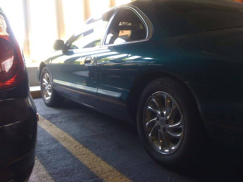

Ok so I walked over to the car just now.. sitting for like 12 hours...
Then I sat in it... heard a "Click" and then "PSSSTTTT"
Now my car is slammed again... (well this pic was taken in the process of slamming LOL) There was NO hissing when I went over to it.. it appeared a little low in the back, but nothing crazy (as seen in pic one)
Could it be just a solenoid, or something telling it to release?
