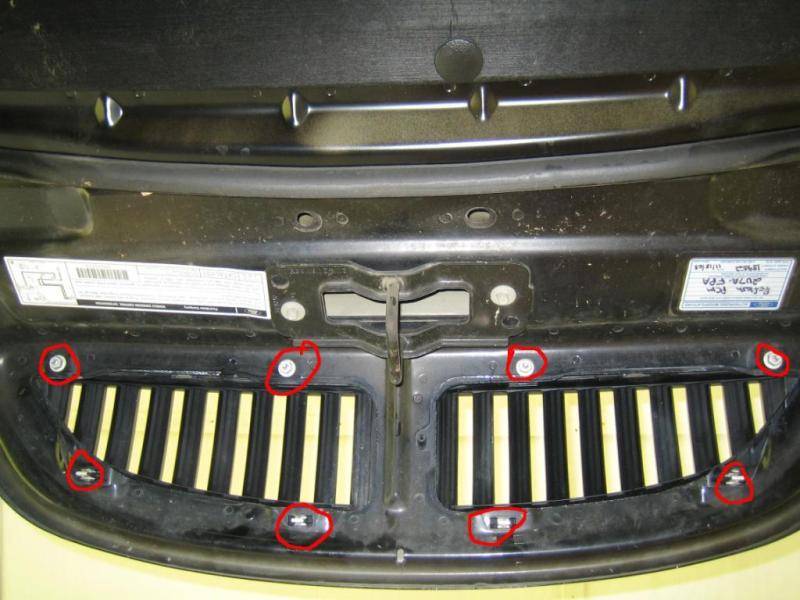

I purchased the LSE chrome grill from Ken as well as the KKM for my 02 LS. I want the angels eyes as well, but here are my questions.
In the top pic are the 4 clips that I have circled and the 4 bolts circled all that i need to remove to take the old grill off?
How do you remove those clips. I always seem to be the knid of person who breaks clips easily, but i want to learn how to remove w/o breaking. I've gotten better over the years but i dont want to screw anything up.

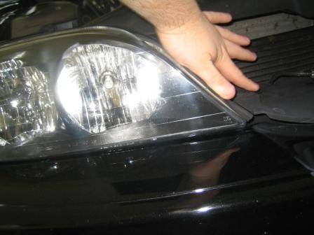

As for the Angel Eyes, I assume that that is the grey sealant and I can install them. Is this correct? Also do i have stock HIDs or Halogen. Thanks,
Those four clips at the bottom will need to be "released". That means you'll need to take a pair of pliers and squeeze the clips as you push them out. You'll see part of the clip securing itself against the hood. Look real close and you'll see what I'm talking about.

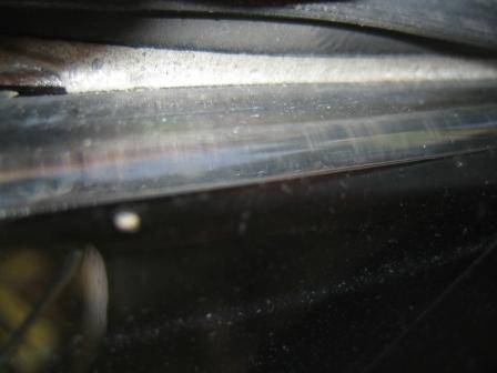

As for the headlights, look at this link below and will tell you how to look and see if your headlights have the grey sealant or not:
http://www.lskoncepts.com/LSK Headlight Guide.pdf
ok. from looking at them i should be fine. thanks for the answer. i appreciate it. and to possible help others i'll post the pics that i took of the grey area on mine. here you go.
Your headlights are good to go for the angel eye install!
