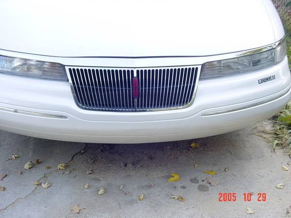

Its held on by a nut in the back. you can get to it by taking off the 3 screws on the top and pull the grille forward a lil.. the nut on the back of the emblem is I believe a 10mm.. don't hold me to the size tho.
