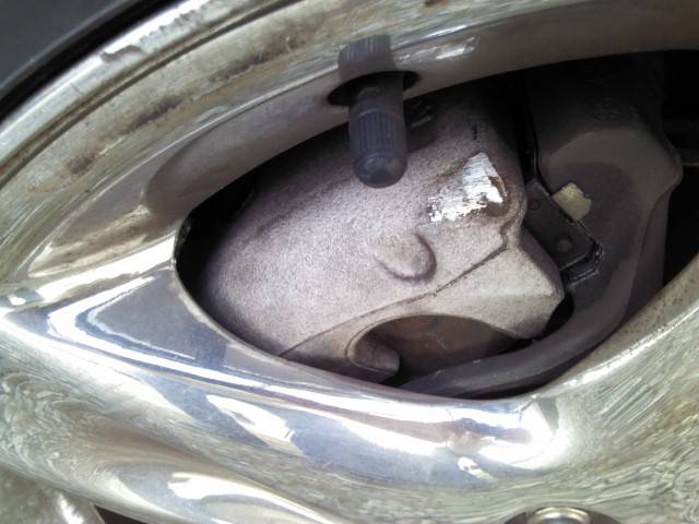

the grinding noise was the wheel scraping the caliper.. Now my question is what could be the possiblities.. I know the pins are frozen so those are getting replaced is that the only cause? See attached picture
The frozen pins shouldn't be the cause of the interference. You said the wheels are stock. What about the calipers (look stock), rotors, and lug nuts?
Is there any play in the wheel bearing?
lug nuts i assume are stock.. i have never replaced them.. the rotors have been replaced. I will have to check the wheel bearing i hope it is not the problem (or i hope it is) it was just put in 2 months ago.. it is a moog.. so it would probaly be under warranty
The rubber around the caliper pins is degraded, allowing the caliper to float more than normal.
