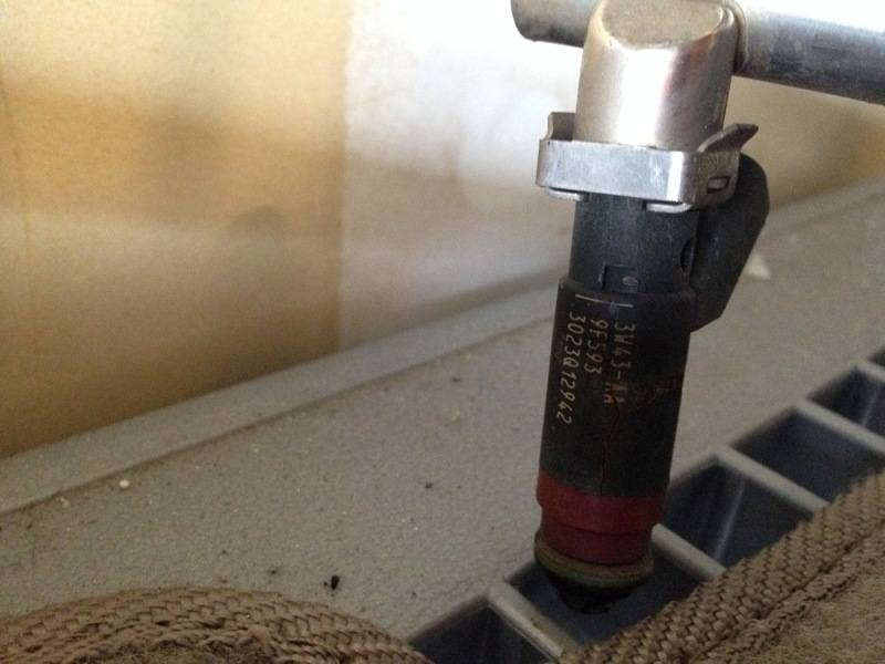

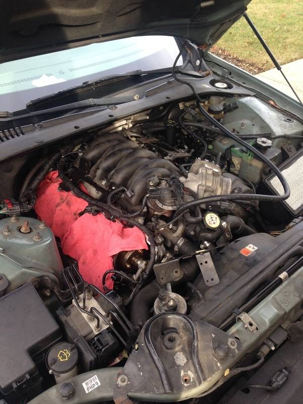

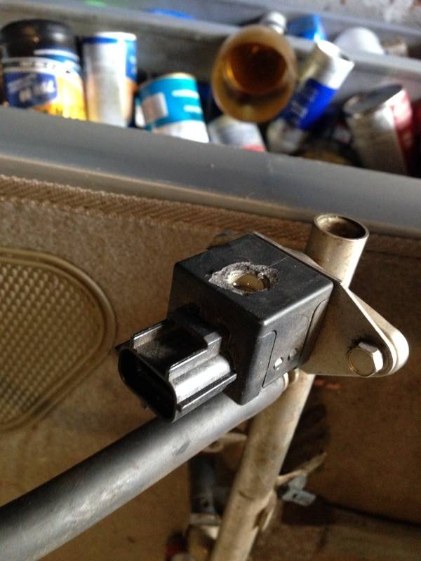

Happy New years to everyone! I got into the LS yesterday and found a cracked fuel injector on cylinder 8. Hoping that fuel was leaking thru the injector and causing the issue. What do you guys think? I also noticed the passenger side spark plug holes had massive amounts of oil so I am changing the valve cover too. Then while removing the fuel rail I broke off the port piece to the fuel pressure sensor. Now the question is what type of fuel injectors and fuel pressure sensor should I get? I see a lot of choices on rock auto for both. I know for plugs and coils I go oem and I would go oem but if I can get away with aftermarket on these I will. Thank you for your help again guys.
