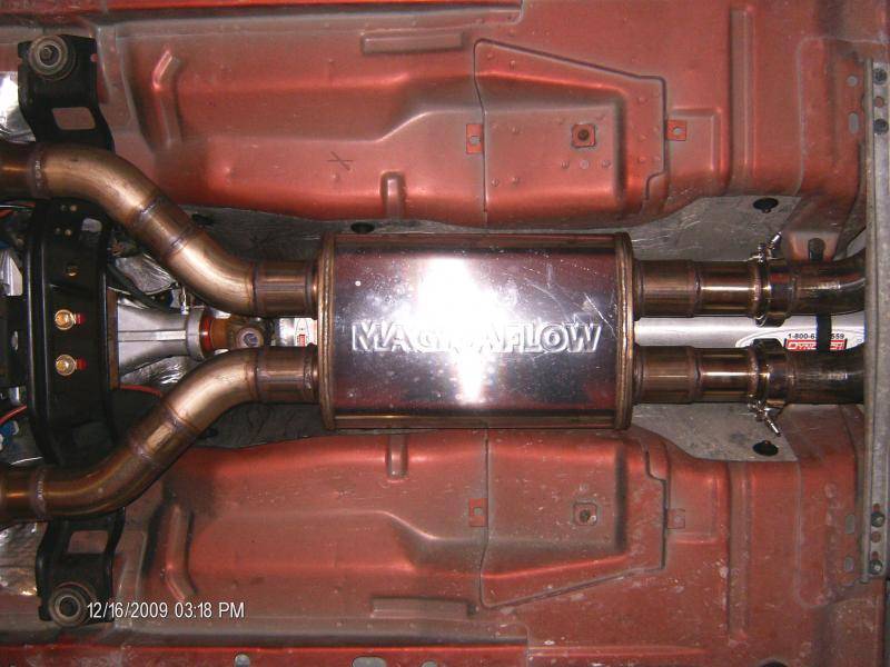

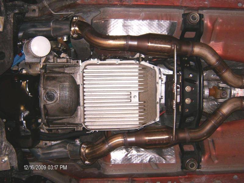

Yes cats at as mini muffs. Mine is all 2.5 dia. As you can see in pic you cannot fit 2 back to back internal X muffs in the space.
I don't think there's enough room for both a Magnaflow "X" muffler and an x-pipe, and definitely no room for two "X" mufflers, and I'm not sold on the need for two anyway. Magnaflow does however, make longer "X" mufflers. Mine has a 14" long, 4"x9" body (p/n 14386), but they also make 18" long, 5"x8" body and 22" long, 5"x11" body (which I don't think will fit in the tunnel) "X" mufflers.

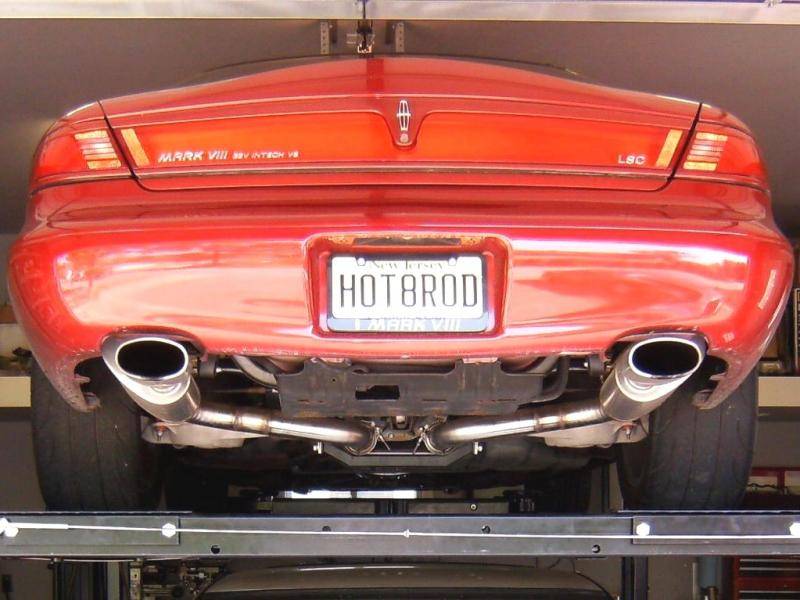

If you like the way my car sounds, why not just do what I did? The rear mufflers that I used (p/n 14211) are tucked up quite well, and really can't be seen unless you get down to ground level.

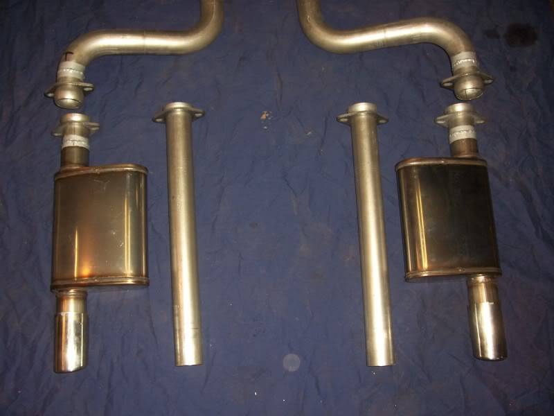

Here you can see my 2 sets of rear pipes. If I ran NO pipes at all I would get exh smell in car. I scored the 2 SS magnaflows for like 30 each off Amazon till they found there mistake and marked them up to 100 each. SCORE.
