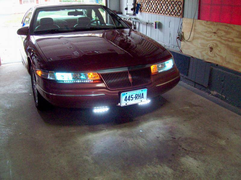

95 new lts 4.jpgI just put LSC lights in my 95. It had base lights with an am kit that just twisted in. In the LSC housings, with adaptor, the bulb would not fit tightly. it was loose and would spin. I took the bulb, and adaptors, and tried them on a GEN 2 housing. They fit perfect. The inside of the LSC's, where the bulb rests, is much deeper than a GEN 2 housing. After trying different things to make it work, I ended up with a thick rubber washer, about the size of a quarter, over the bulb and red rubber washer. It worked out well, nice and tight. I've been told there are different am kits for the Gen 2 housings, but my gen 1 kit worked in them. All is well, and they work great. I added some drl/fog lights, and my wife reports that she can see when it's dark.
