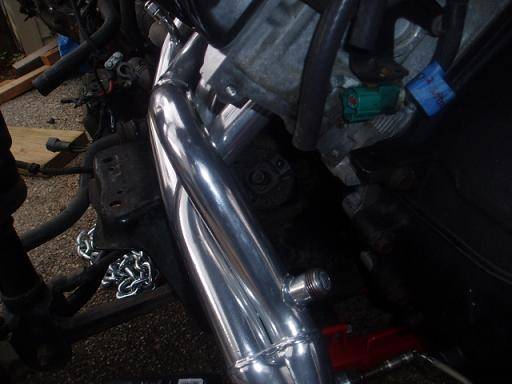

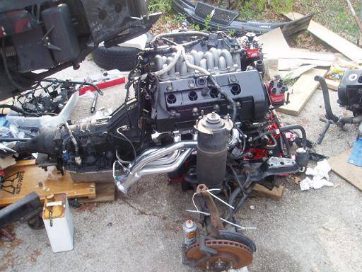

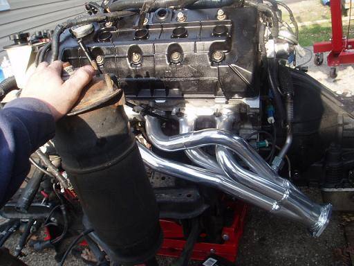

I just finished putting the kooks on my engine I am swapping. here are some pics. just 1 question for geno, I am sure about the drivers side header but the pass was a lil more difficult, is it possible to tighten down too tight? there was no way of getting a torque wrench in, I know the factory manifolds say 23-26 ft/lbs (or something like that) so I didn't go crazy with the bolts. do you think I will be ok or how tight should they be?
Just do them very tight, you should also throw on a film of high temp silicone on both sides of the gasket.
I see you used the origonal studs, mine came with 8 bolts for both sides(top). probally doesn't matter tho, and I had felpro gaskets and was told I shouldn't need any silicone with the install.

Holy crap do you have to drop the whole subframe like the pics above to get them in? Those pics almost made me Yak!
no he drop it because he is putting in a new motor
