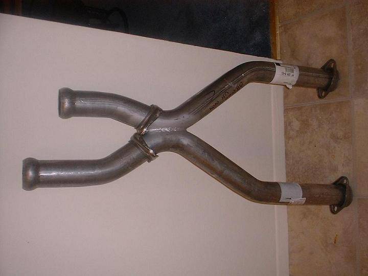

Stock exhaust manifolds
Stock H pipe with cats

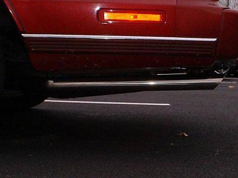

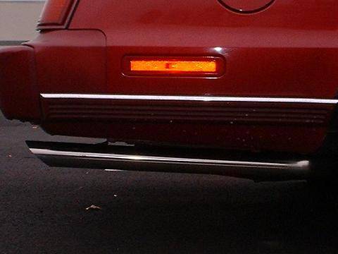

My buddy Nick does polished stainless and stainless exhausts for the VIIs. All you have to do is buy the over-axle pipes for a Mustang (in whatever diameter you want) and he'll do the rest and ship it out to you.

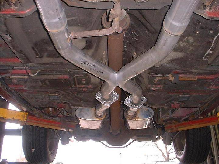

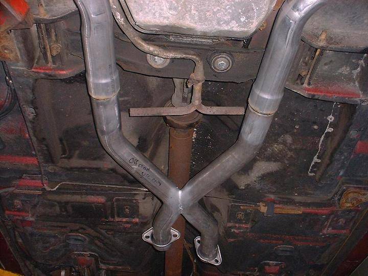

92 LSCSE
Stock Manifolds (for now)
customer made down pipes into x-pipe 2 1/2
Magnaflow stainless mufflers
Mustang mandrel 2 1/2 tails over the axle into custom polished stainless tails
All custom made by myself, if you need exhaust in the NY, NJ, CT area give me a shout

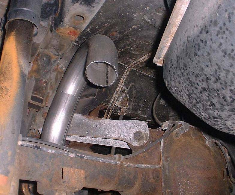

I did have 2.5" from there back with 18" HOLLOWED glasspacks and square Chrome tips out the corners of the back tires - looked sweet, sounded nice. The glasspacks were basically just expansion chambers for sound - no dampening. I have ABSOLUTELY NO DRONE WHATSOEVER...I have since SOLD this catback to a guy on LOL *cupcakeLSC, and he can verify that it is a nice sound and no drone :)
I had to ditch it due to clearance problems of the Panhard rod. I will need to run outs in front of the tires now - going to be hard!
