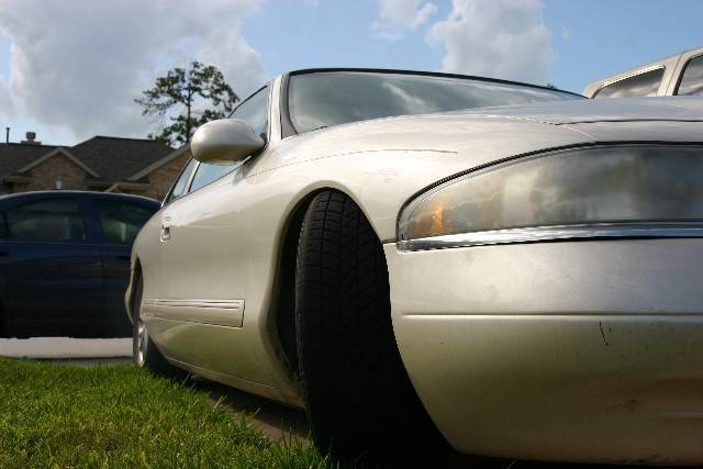

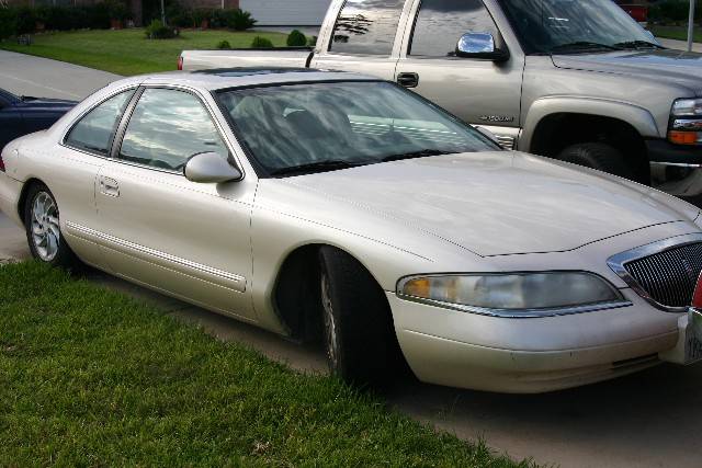

I need some solutions to clean these headlamps. I want to try this before I purchase new ones. Does anyone have any ideas? I've heard rubbing compound, 1000 grit sand paper, Anything would be helpful.

This is what I did... Start by cleaning the lense with water. Then take 1000 grit wet sand paper to it. After taking a good layer off go down to 1500 wet sand paper, then finish off with 2000 wet sand. Then polish the lense with plastic polish. I used blue magic.
how it started-
the end result-
nice and bright!
