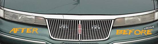

I too have done the HID conversion, and I must tell you, it is well worth the investment. If you plan on keeping your Mark for years to come. Here's my Mark.
GMAN
