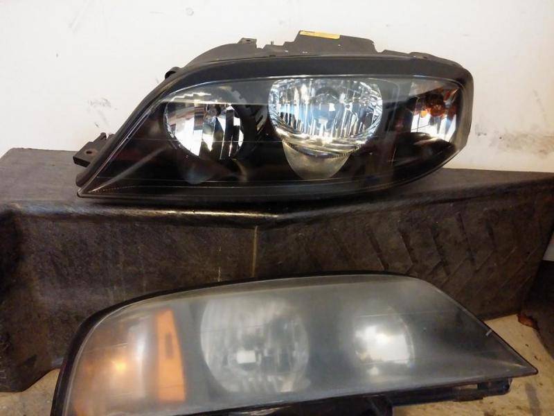

Thanks to the advice of you fine folks I tackled my headlights last weekend. I actually tried this last summer using the 3M kit, but i used their protectant crap which only lasted a month or so before the haze came back. This time i finished with Spar Urethane, but out of a spray can as it was much, much cheaper than the gallon size they sell here, and I only needed a little. They turned out great and I've gotten a lot of compliments, including one guy who tracked me down in Home Depot in a slightly creepy/stalker way to tell me he loved it lol.
BTW don't mind the scratched on the right side of the finished light, I got swiped by a car once and they are too deep to sand out.
All in all it took about an hour, including the time spent removing and putting back in the lights, but I also did a lot of the gruntwork last year so i didn't need as much sanding this time. I imagine starting from scratch it would have been 2-3 hours or so tops.
