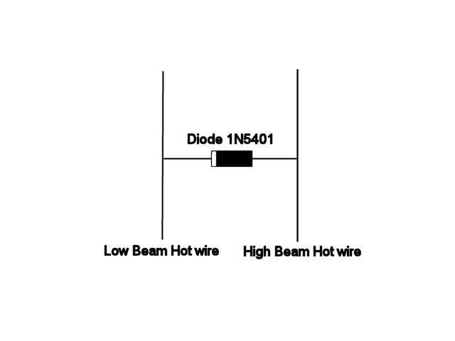

On the 1995 MarkVIII the lights when switched to bright, just the two lights are on, I have been told the 1996 Mark VIII all four lights come on when
switched to bright. Can the 1995 be modified to do the same as the 1996,
if so explain how this may be accomplished.

A hid bulb requires some "warm-up" time. If they turned off during highbeam operation, you would have a couple of seconds of darkness while you waited for the bulbs to warm up when switching back. To remedy thins, Ford changed the wiring around to run the lows all the time.
I have heard of people re-wiring the car to run both at the same time, and yes It does make a difference. You can notice this by driving at night, and holding the "flash to pass" function held back. I used to do this in the 94 when I would drive it at night.

You can do it in 2 different ways. You could wire up a relay that when the high beam is on that the low beam comes on/stays on as well. Or you can simply put a diode inbetween the low/high beam wires that when the low beam is on the high beam stays off, but when the high beam comes on the low beam stays on. With the diode it allows the current to flow in only one direction....hence the low beams are on, but not the high when the headlight switch is in the low beam position, but the low beam is on when the highbeam is actuated.
My car has the later (diode).

Do you have a diagram showing us how to do it, if you have time?

But I would like to see how to do what you said Ray with the wiring.
Here is how I have mine wired up. Using a relay will require a bit more work and wiring......I was a bit lazy....LOL. :Beer
got my head lights to work ray, thanx. i sould be getting those new driveing lights in next week. did you ever find that diagram for hooking the light up to the automatic switch?
