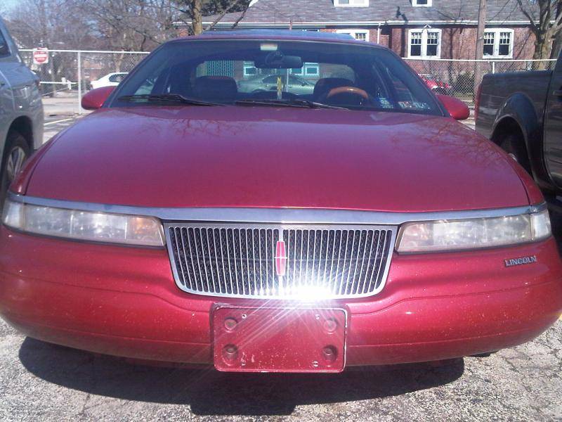

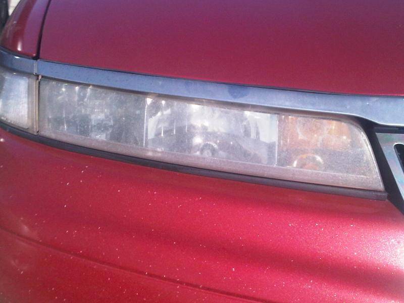

Got any BEFORE pictures for the doubters?

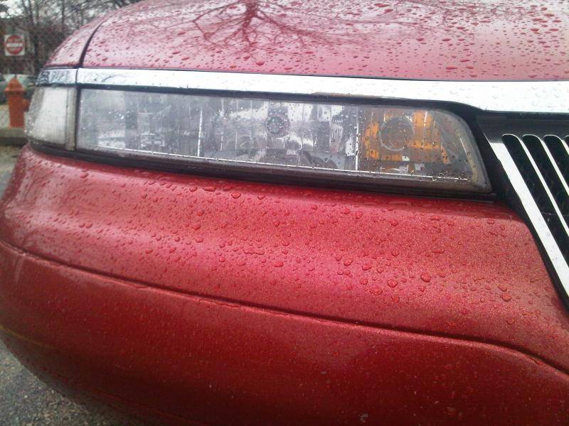

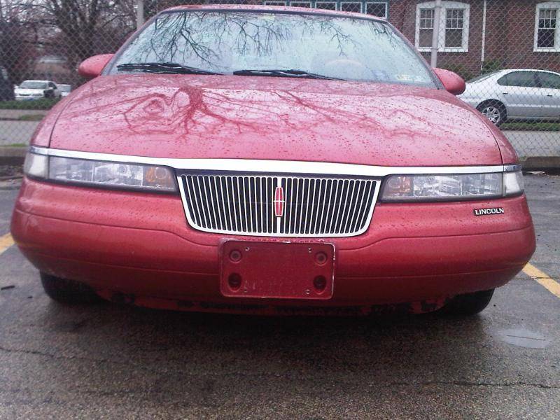

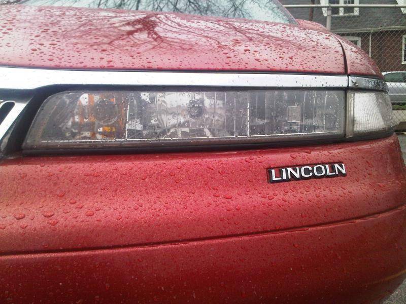

I will recommend this and only this product as I can say I personally tested it with great results...
I will include pics..
3M headlamp restorer autozone 21.00 need drill !

DAYUM!
Now THIS is why I suggest that EVERYONE take pictures NOW no matter WHAT you think your ride looks like!
Nice work!
