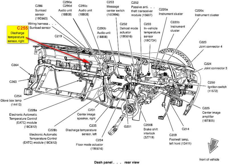

Quick revive... so is the driver side air discharge temp sensor the same as the dccv or are they two different things? I cant find this thing either..
wait I think I found it and for anyone who needs to get to it you remove the glove box to get to it..
No, and your 2nd post is highlighting the passenger side, not the driver's side. Driver's side is easy to get to, as is the evaporator temperature sensor. The evap temperature sensor on my 04 soft failed (became marginal), and I've heard of that with a few other LSes.
