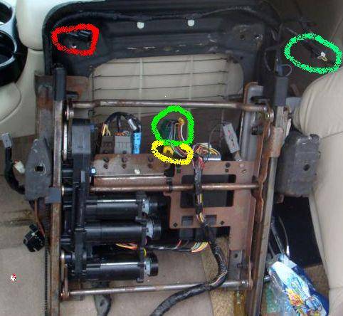

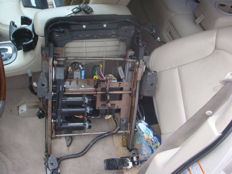

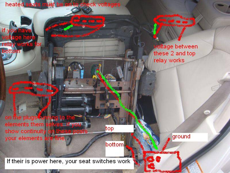

First of it has a element not air tubes. Drivers side bottom element is out. 3 things I'm gonna check, switch, box under the seat, and continuity on the element. Is their a normal part that goes out on these? Please help, my ass is cold.

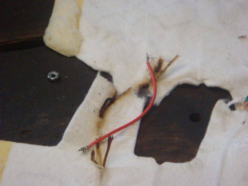

Alright, Its fixed. In hind sight I'm lucky I didn't light my nuts on fire or lose my lincoln. 4 hours labor, pretty straight forward, soldering skills, and mechanical skills needed. Good thing the wire burnt all the way through, it never blew the fuse.
In case anyone wondered. Red is the lower heating elelment, Teal is the back rest heating element, yellow is the airbag, green is the power in for the the heating relay.
