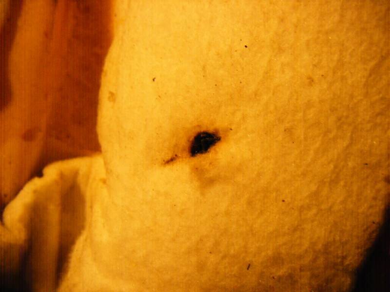

If you take the seat covers off and inspect the portion of the seat that doesn't work you'll probably find a burnt section or two where the wires are ran inside the element.

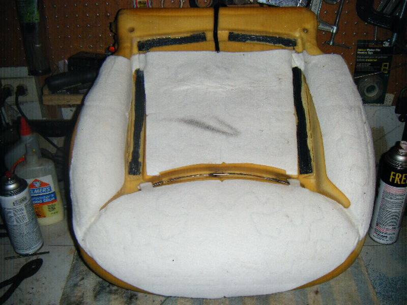

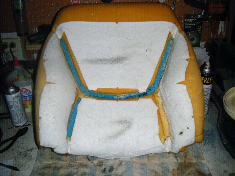

I think I have my old foam top and bottoms with elements attached in the garage, i'll have to check when I get home.
Back portion:
Top center-
16" wide @ top
10" wide @ bottom
9" tall
Bottom center-
11x8
Sides-
17x5
Bottom portion:
Front-
18x8
Center-
11x9
Sides-
13x4.5
Why they usually stop working-
