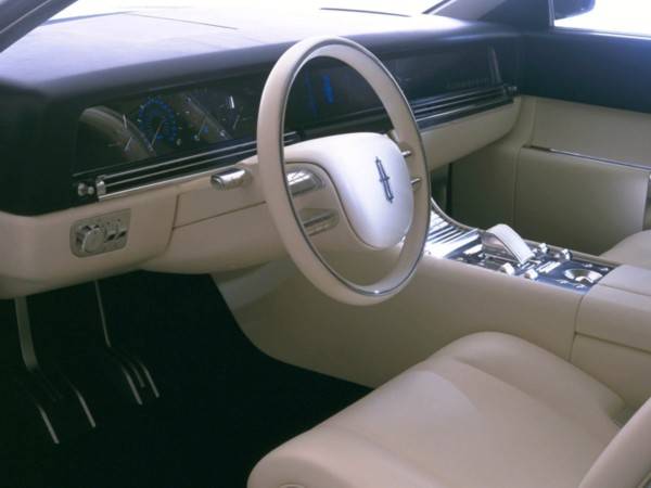

My Dad works on classic cars since I was an ankle-biter. So I generally listen to his advice - he said take out the heater core to have a look as it could be repairable with a bit of welding/plumbing. It is (only need to braze a small whole at the top) but it was quicker for me to do the AC trick. I have to take the dash off again anyway because I'm making a custom interior similar to the new concept Continental. So when I put that in I'll do the heater core properly.
