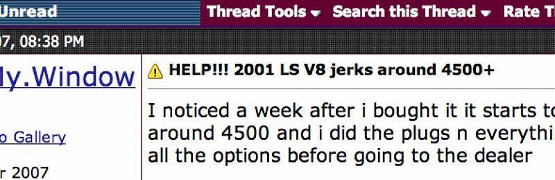

Year and engine would help in the diagnosis,
I'm betting it's a 2001 V-8...
