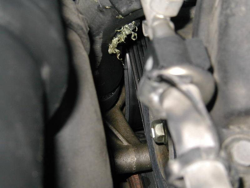

Today while getting on the freeway the damn V6 blew a radiator hose.
It looked to be a 90 degree hose that ran from the water pump into the block, had a nice 1 inch slice in it.
Anyone know of any special procedures for filling the cooling system? Also will I be able to get the check engine light to go off just by disconnecting the battery once it's fixed?
Any help would be appreciated.
Can you spot the blow-out?

Same thing happend to me, but on the track at Waterford Hills. As long as you didn't run the engine without any coolant it should be fine. It's a relatively easy hose to replace. the refill does take a while because of the purging of air in the system, allow yourself at least a half hour after you get it up to temperature to get it totally purged.

Tore into it today and decide to check the purge valves. The on on the top radiator hose was just sitting in there. There was no threads on the bottom of it. Don't know how it stayed it there for so long. It looked like someone burned the plastic threads right below the o-ring or something.
This was a known problem. The new hose is reinforced at the 90º bend. Mine blew at ~55K miles and it was one of the few things not covered by my Ford ESP. I had the thermostat replaced while they were there. IIRC, my total cost was about $140.

Got her fixed! But I have to order the upper hose because of the messed-up bleed valve. Can't just buy the bleed valve, gotta buy the whole hose ($170.00 by the way). Good to be an LVC gold member $100.00 through Maxx @ 5 star ford.
