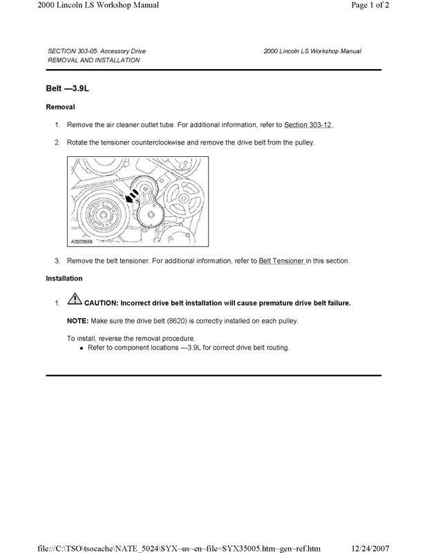

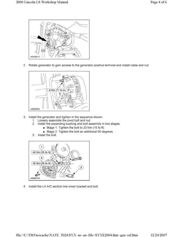

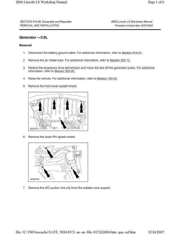

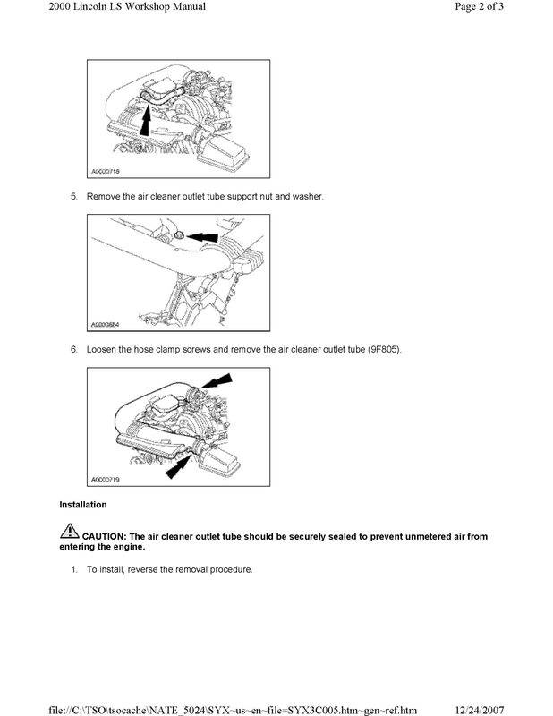

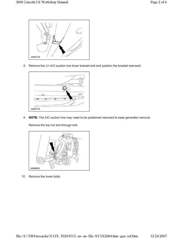

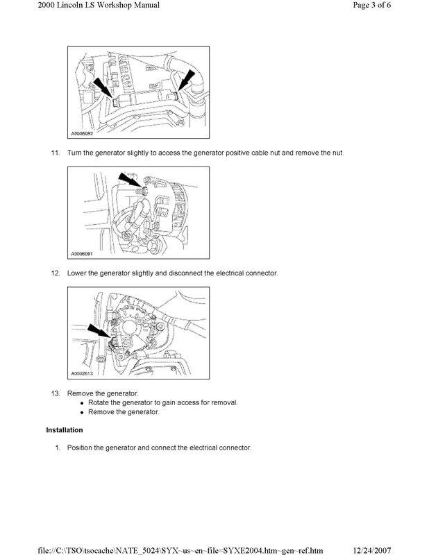

Okay here ya go. alt. replacement first, supplimental instructions second.
I'd print that out if I were you... it'll be easier to read
