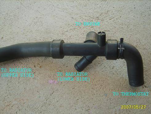

My LS 2001 V6 overheated. On closer inspection I found that this one part shown in the pic bellow was the problem. I went to the dealership and they quoted a $250 price. The rip off is that this piece is one piece of a 4 piece cooling system set. So the dealership sells the whole 4 piece set for $250, but all I need is this one part. The other three hoses are fine. Any ideas what this part is and where I can get it??
I'm really stressed dealing with the dealers! Please send advice if you got it. Thanks everyone.
Part Number
There is a part number or something like that on the tube. (backwards Y)W43-8b502-AA, if that helps. The part was located underneath the intercooler. I know someone out there's got to know what this is!
The part is just plumbing for the coolant fluid. Nothing electronic, no pumps. Seems to be just a hose, but it does have a valve with a hose that goes to the intake (this is what blew off, in the first picture it is the smallest diameter pipe on the left). I guess when the intake needs cooling, the vacuum pulls the coolant through the hose and runs it to the intake.
that is a YW4Z-8B502-AA hose and retails for 203.00 and lvc is $118.76 I can have one tomorrow and ship it to you.

I may need one of these myself, as I have noticed a trickle of green coolant from the plastic to rubber crimp on the largest part of the pipe.

If you're feeling adventurous it seems like you could go to a hardware or plumbing supply store and make this part yourself for a fraction of the price!
Issie...There is a lot more to this than we both thought and your pic shows.....it even has the t/stat and housing attached and all the hoses...this is an octupus!! it is shipping today and you should see it on next wed or thurs. I would replace the complete assy.

I figured it might involve a hose or two, or eight, but the service does not look too complicated. thanks for all your help.
