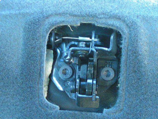

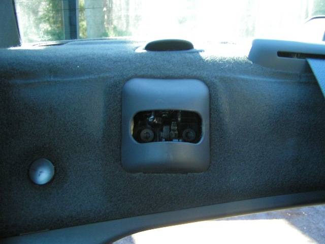

this is what the machansim looks like with the cover on. You'll have to get behind this cover with your wire hanger or whatever you use.

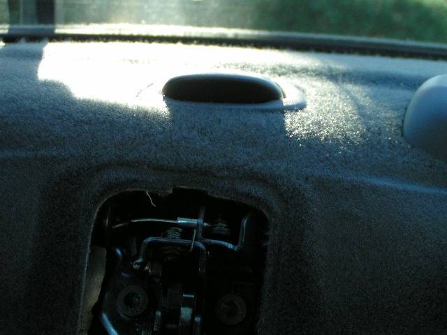

this is what it looks like with the cover off the release cable pulls the lever from right to left. you'll have to push the part at the end of the cable to the left
like this:

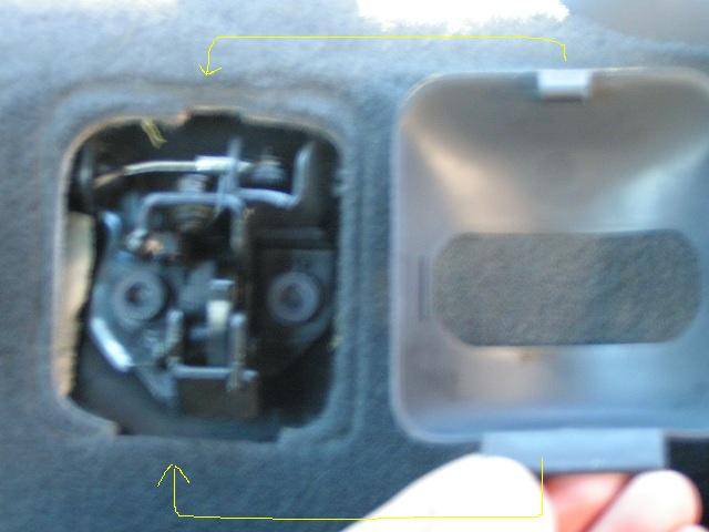

sorry for the blur its cold out! this is how the cover attaches over the mechansim all you'll need to do is get past behind the small tab on the top to the right of the tab.
this is where the mechanism is in relation to the back dash and the baby seat latch thingy so you can get an idea where the mechansim is since it will be hidden by the seat.
be careful of the leather on the back of the seat but don't worry to much becuase it ends right below where you can see and turns into carpet.
i would do this by trying to trip the lever with the hanger or something while having someone pull fwd on the seat a little, and if that doesn't work after awhile maybe without the pulling. a regular wire hanger might bend too easy for this job, maybe something stronger.
i was able to trip this lever with the cover off I went in from the side rather than the top though. you'll have to go in behind the cover, I think this will be harder than I first thought, good luck. i think you will have to dig into the carpet a little to get behind the cover, it'll jam and pull but you should be able to push through without really damaging the carpet.
