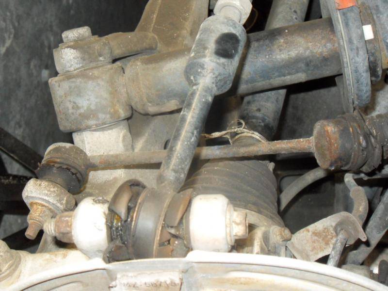

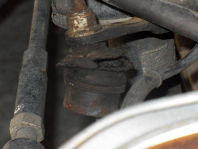

I have some photos to illustrate:
Outer bushing (closer to the side of the car):
Inner bushing (closer to the middle of the car):
The inner bushing is the one creating the noise. It was rather collapsed, as compared to the upper arm. I do believe they are filled with some sort of oil, as per Joe's post here: http://www.lincolnvscadillac.com/showthread.php?t=66505
Sounds like you need to replace the arm then. Unfortunately there is no aftermarket bushing.

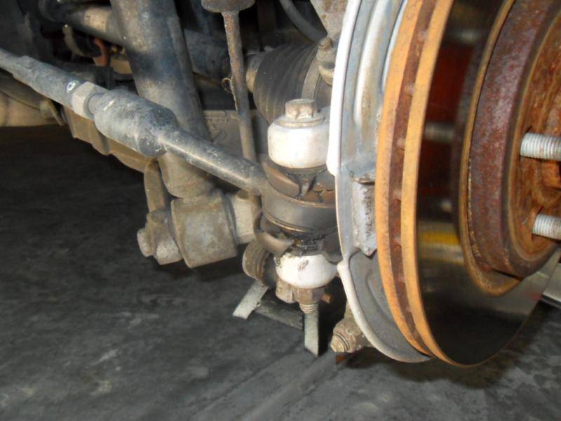

I took one of my rear tires off today and was inspecting my rear components. I'm in need of rear end links and tie rods like everyone else. Might need to get this done before I have to get the car inspected next month. Haven't had any squeaking going on but by the looks of these parts, I'm sure something is bound to happen soon!
Wow LeaSr... You need toe links and sway links. That is some major deterioration!

Also, damn M4rk, your LS is rusty as fvck!
Ow that's bad! Have you done your bearing recently? :D I held my half-shafts by a string as well, to prevent them from popping out.
Thankfully my tie-rods are fine for the time being *knock on wood*, but they're deteriorating due to rust. I peeled chunks off mine like a banana.
@Andrizzle Salt sucks! Most of it is just surface though.
I'm glad someone else commented on it. I was looking at all that cancer and thinking "Damn I am glad I live in Florida". Mine's usually only got road dirt/grease caked up on it.
@ Drizzle yea man I know, I need to go ahead and get these parts in so I can change them out when I do my springs. Bought a Ingesoll Rand air compressor about a week ago so I can do most of the repairs on my cars from now on.
@ M4rk I've replaced the rear passenger side hub about three years ago. Haven't had any problems with the rest of them.

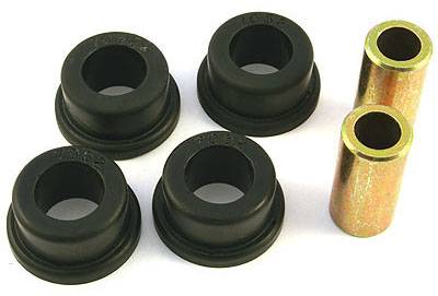

Hey guys just made an account because I have the dreaded LCA squeak. I was contemplating buying a new LCA for $300 each or trying to press in jag bushings for about $200 for both sides. I was trying to figure out a way that I barely have to spend any money to get them fixed, as mine are not cracked that I can see, just a terrible squeak that make it seem like a 100-year-old car. I was thinking about putting some conditioner on the rubber parts to help moisturize them and not have to make my own grease fittings. I ran across this old video by YouTuber I watch often and decided to give this a try today.
