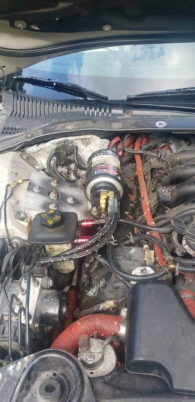

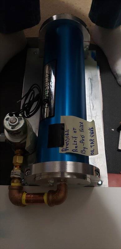

Don't worry about it. My 04 Sport had it from 21k when bought used. At 480+ still there. If driven every, the rattle time decreases some. The intake cams are hydrualicly controlled and the devices are on top the head. Could do this. An Amsoil by-pass filter to super clean the engine oil & an Accusump accumuator to prevent no oil pressure start condition. The only place on the whole car for the three quart is between the rear speaker under the back glass. Used a mock-up all over the car to find that location.
try this: Oil Additives - Nanotech Industrial Solutions
AC-1000 Gasoline engine oil additive. Used it at 253k when the valve train was to begin to rattle. Place 12oz to 6.5 quarts with three minutes of idle time the rattle ceased and haven't heard it since.
